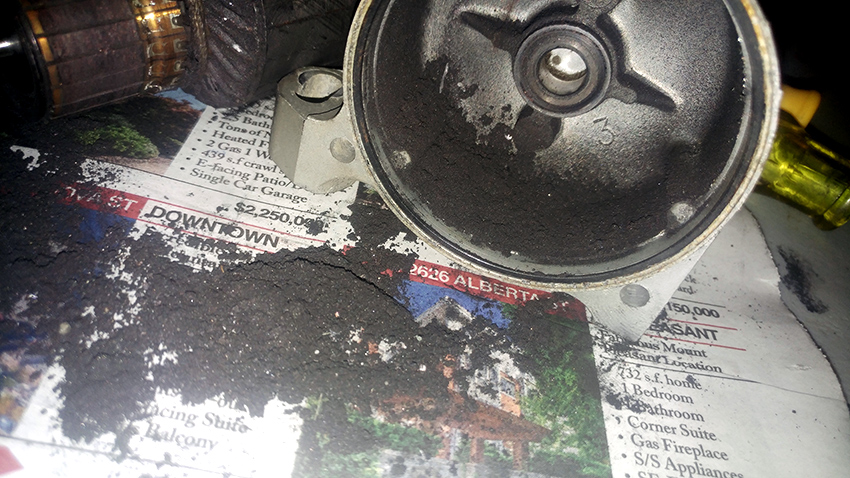

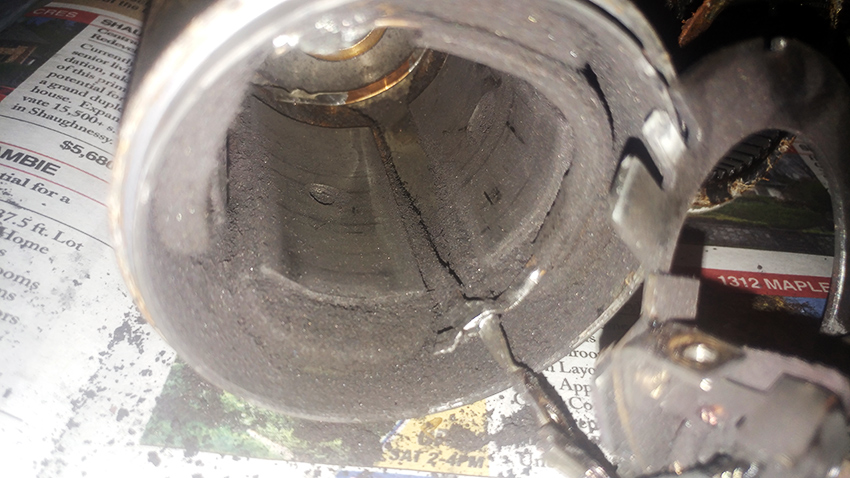

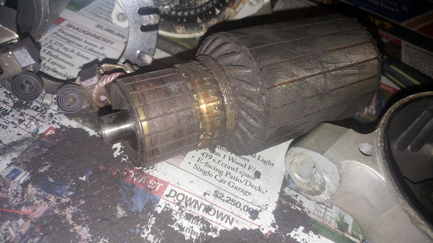

Cheers! I can't find where the hell I posted it, so I'm just posting again the picks to illustrate what wrath starter can bring.
This is not KZ1300 - it's a GL 1100 Goldwing. 1983 - same era.
In the KZ1300 post I had you can see similarities. Way more rust, and that you probably wouldn't have in your starter. But the carbon dust from the brushes - definitely!!!
So... This starter worked wonders. Two years later, loosing power. Especially in winter. Changed battery after a fucked up leaving the bike on parking light. Drained the battery beyond rescue. Next battery in warm weather. Similar stupid mistake. New battery, charging, riding - got it under control.
Next... The cranking power became weaker and weaker. Just like you described with compression. Making long story short, after opening the sucker I know that the cranking power depleted with the build up of the 'death black powder'. And at he end - it went cold dead.
The below photos show what was inside.
Fast forward. That DEAD starter got a clean up, and in this case, a new set of brushes. Lubricated, TLC. Put it back on the bike - WOOOWZA!!!!!
That was before cold winter months and it still cranks today in summer like a champ. And it will for year to come.
I think I've said what had to be said already, now a couple of picks.
Disassemble, clean, lubricate, assemble, install - and my feeling is your KZ will crank as if never been cranked before
