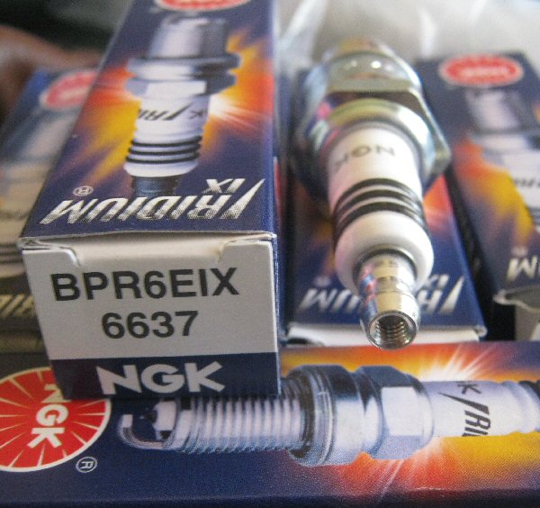

It is a bit "cheeky" of NGK not to make that difference obvious, but it got me good & proper so I wont make the same mistake again !!
Pete F
Pete F
- Toddh
- Posts: 440
- Thanks: 62
Re: SPARK PLUGS ?
12 years 3 months agostrate6 wrote: It is a bit "cheeky" of NGK not to make that difference obvious, but it got me good & proper so I wont make the same mistake again !!
Pete F
I think the way to remember, and to get the word out on is the color of the tip.
The ones that come off are aluminum (Silver)
The ones that are permanently attached are (Black)
T.

Todd,
Correct,
Problem is most suppliers just use a Generic Plug Images on Ebay........so the only way to be certain is to ask the question.
The "11" spec plugs I bought had a silver cap in the Ebay image but arrived with fixed caps.
BE WARNED !!
Pete F
Correct,
BE WARNED !!
Pete F

So you use a gap of 44 thou ??, will investigate, have Accel coils so spark is good, plugs have arrived at post office, ones with removable caps, will try them this weekend, cheers
Just picked up the plugs, correct top, will put them in later after a cuppa
