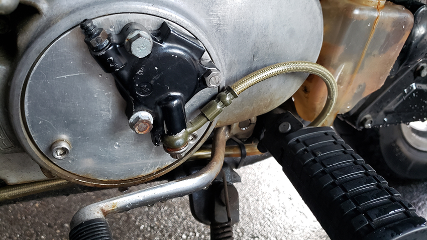

This is NOT the correct orientation for this slave. Bleeder port (internally) is below the top of the slave piston, trapping air.

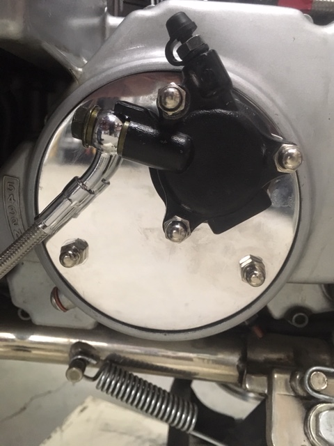

This is the correct orientation. All air can be bled from the slave as the bleeder port is at the top of the piston.

Thank you. I haven't gotten to addressing this yet. I did check and bled it just a tiny bit before riding, and it was all good. But I will turn it later clockwise. In this case I think the bleeding nipple will be facing towards the rear of the bike.
