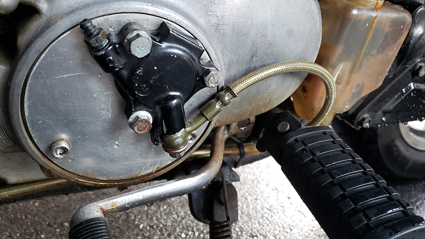

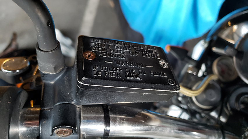

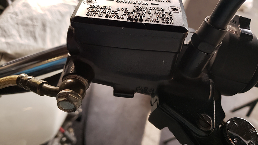

Does anyone recognize this clutch conversion? Did this come from a source offering these or is it 'home made'? I'm also wondering what value this might have - simply out of curiosity as I'm keeping it. It works great but I must say I don't find it lighter than the stock I have on the other 13.

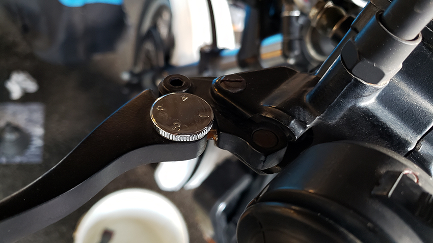

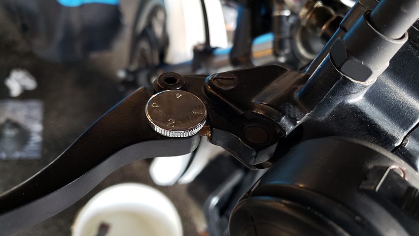

The lever is adjustable - levels 1 to 4.

There are instructions for that conversion on the forum. Someone used to sell the plate, but instructions where clear on how to DIY.
I've done it. Found the Hyd to be smoother. Though mine is probably not any lighter.
You can get a smaller Master Cylinder if you want a lighter feel (but it will require more throw). 1/8" inch makes a noticeable difference.
That conversion could use a non-oil soaked line and some decent bolts. I ran the cable forward instead of back.

I had it set at the most travel of the piston, so perhaps this made it hard - I just wanted the clutch move as much as possible as it was stuck from sitting.
I can imagine being easy at lower setting. And yes, it was smooth despite the carburetor not delivering smooth at times. The bike ran fine. This conversion works great and the fluid inside was crystal clear. I'm actually not sure yet what I'd do later, as I am after stock look and collector plates. Stripping the black paint will make it all shiny, and it might be just fine. I think here in BC, Canada, it is not as strict as with cars. Motorcycles are permitted some changes if it helps safe operation, as long as the overall shape and look is true to the era. I'll probably get away even with the 6-1 instead 6-2 exhaust for a while until I get the exhaust sorted out.
