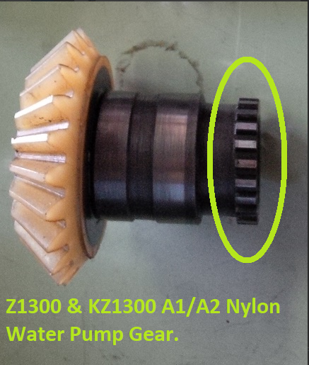

If you have a Z1300 or KZ1300 A1 or A2, then your Ignition Pick -Up Unit will be situated on the RIGHT HAND SIDE of your engine behind the cylinder block.
This Ignition Pick-Up Unit is driven by the same centre shaft inside the engine which the Nylon Water Pump Gear is also on and the Nylon Gear has METAL TEETH on the opposite end for another Metal Gear to fit onto which then drives the Ignition Pick-Up Unit.
THIS NYLON GEAR WITH METAL TEETH ON THE OPPOSITE END CAN BE SEEN IN THE 1st IMAGE BELOW.

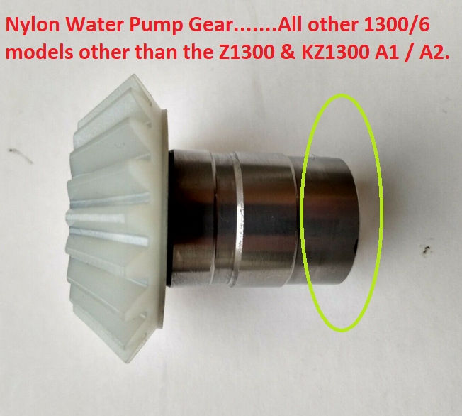

If you have a Z1300 or KZ1300 A3/A4 or A5, then you will NOT have an Ignition Pick-Up Unit like the A1 and A2, as yours will be positioned on the end of the crankshaft. This also applies to all other 1300/6 models other than the Z1300 & KZ1300 A1/A2.
As a result, your Nylon Gear DOES NOT NEED the metal teeth on one end, as it is not driving anything other than the water pump impeller shaft.
THIS NYLON GEAR WITHOUT METAL TEETH CAN BE SEEN IN THE 2nd IMAGE BELOW.
I am of the understanding that the A1 / A2 Gear can still be used in the later A3/A4 and A5 Models, as it will still fit, but the metal teeth are then just not used.
