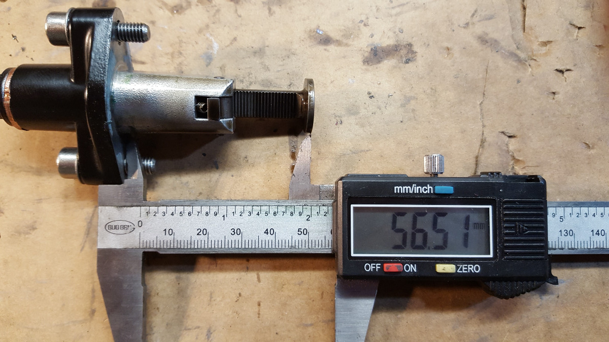

Paul,
I am pretty sure the fault is not the Nylon Gear.
Take your ZX tensioner out and take a photo of it fully extended next to a tape measure for reference.
I will do the same over the next hour and post it too (after me dinner)
Then we can kill or cure the tensioner being the culprit ??

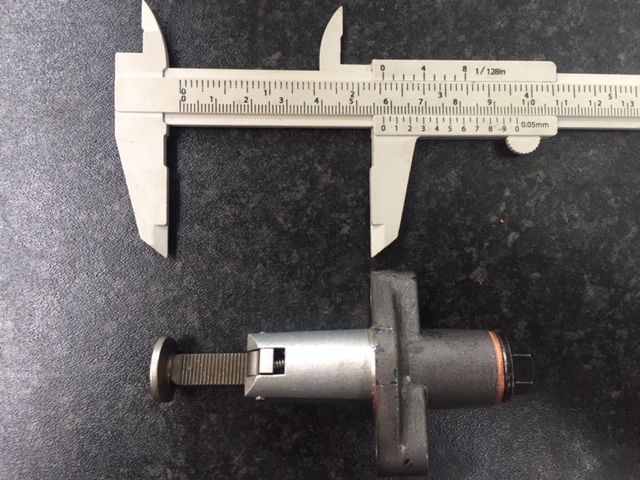

Paul,
My tensioner removed for my bike at 7.30pm tonight.........the tensioner is obviously not the problem then !!
