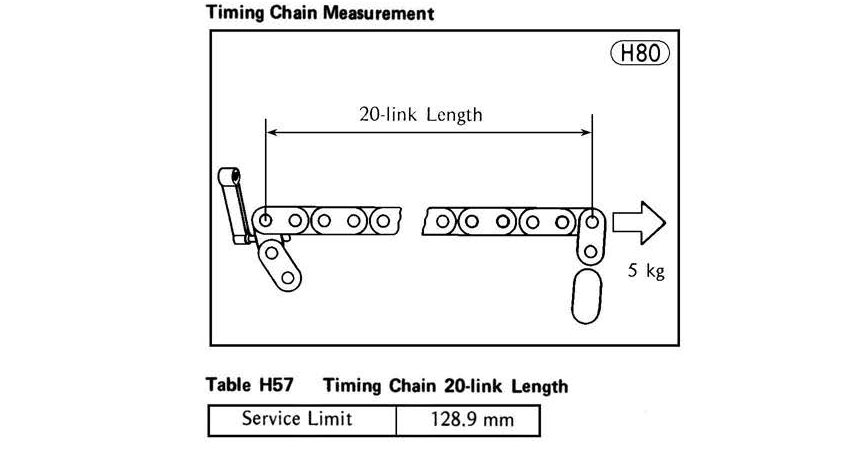

I'm not buying it. Something is wrong with your ZX 10 tensioner mod. Not sure what but if the cam chain has that much slack then the tensioner is not taking up the slack. The fact that you're at 17 clicks out of 19 indicates a problem. As I remember it, a reasonable worn chain with the ZX 10 tensioner mod usually comes in at 10 to 11 clicks.
Before jumping to the conclusion that the chain is worn beyond the service limit, you need to measure the chain as per the manual page 191, table H57.
If this measurement indicates a chain beyond servicing, then replace the chain. If the measurement indicates the chain is within service limit, then you need to sort out the real issue.

Thanks Kawboy, I measured and from the centre of link 1 to link 20 is 12.2 cm. I am sure I measured the chain before I put the engine back together as I measured the primary and secondary ones and had to replace those... but consciously decided the cam chain was OK.
Also, when I was setting the timing and valves, the chain was far tauter at the top....
So what can be wrong?
