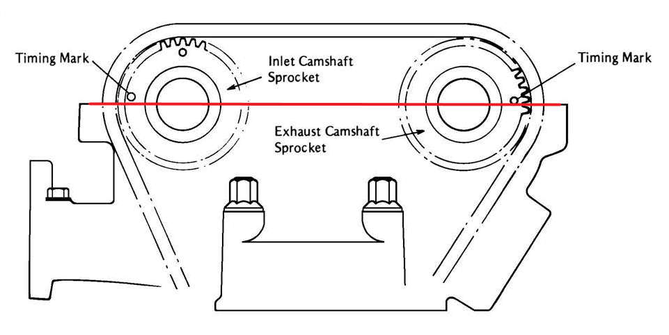

I am assembling the engine after revating the cylinders with new pistons, and now I am in doubt of the correct setting of the cam chain timing.
I have set it as I think it is described in the manual, picture 1, but when I compare with how it sat when I disassembled the engine, picture 2, it looks like there is 1 edge to difference. In both pictures the T mark on the alernator rotor is spot on.

The service manual has a really good explanation of what is the correct set up. I added a red line to go across the cylinder head half joint and it shows the bottom of the circles just above the line.
