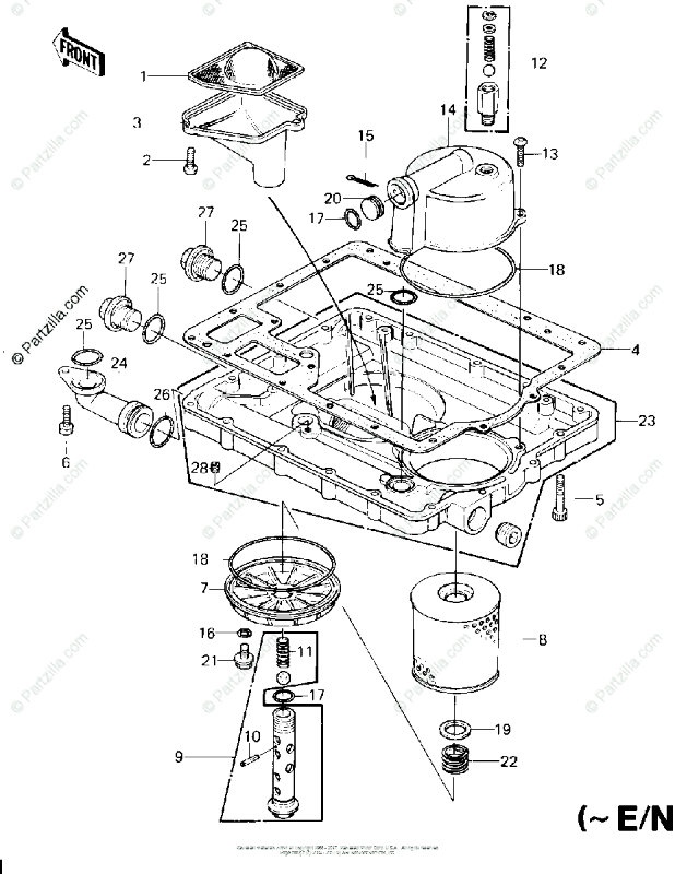

Perfect example of where an exploded view of the part is needed. I like to go to
www.partzilla.com
for part numbers/diagrams. In this case I pulled up a view of a 1982 KZ1300 A4 oil pan. Link here -
1982 oil pan KZ1300A4
There are no internal parts identified behind thise plugs so I'll suggest they are casting access "ports that got finished off with plugs. I would pull the leaker, clean everything up and seal with Loctite pipe sealant

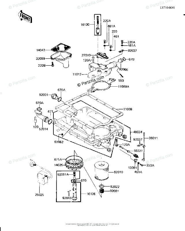

The diagram above is for the later DEEP SUMP, whilst the one shown in the photo on the bike is the earlier Shallow Sump.
Pete F
UK.

OK, just to keep everybody happy, here's a pic of the SHALLOW SUMP 1979. As far as the plug goes, no difference.
