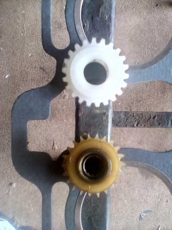

Holy Crappers Scotch. you turned an "outtie" gear to an "innie" gear.
the top gear in pic is a brand new Kawasaki tensioner gear
The bottom gear is a tensioner gear that came out of my KZ1300 at 42K Km.

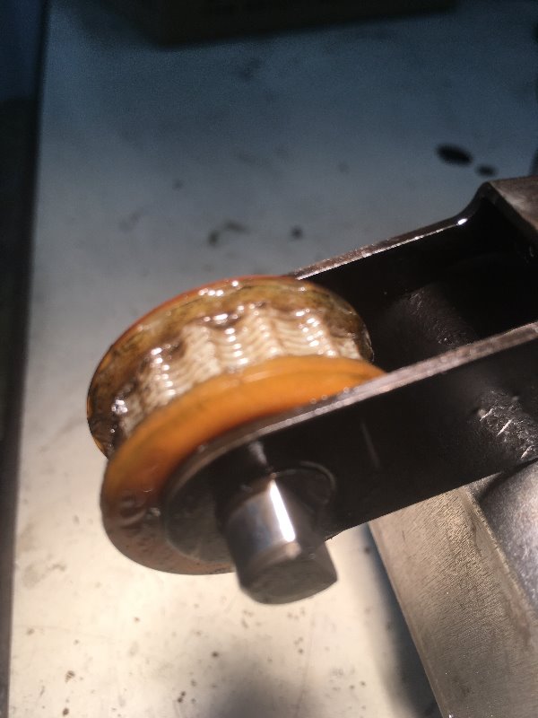

Is this from your bike scotch? Did you mention a while back that you intended replacing this sprocket with a steel alternative?
Have you ever carried out a compression or leak-down test. on your engine? I just wondered how it is fairing after 90k km. Does the bike feel as powerful as you would expect?

I've been putting off replacing the sprocket for the past several years but it's worn-out now. This year I noticed a "lack of enthusiasm" from the throttle. Rings-n-valves, now, as well.
Cylinders glazed like mirrors! No scratches or flaws. No ring-ridge. Piston-domes are pretty sooty but otherwise in excellent condition. Valve-stems have some coke build-up.
Having the cylinders done properly at a machine shop. Hoping a precision honing will be all that's required but have a "Plan B" if required. Will have to see what lapping accomplishes. I don't want to start cutting seats and grinding valves only to end up in the nightmare of not having enough clearance for even the thinnest shims.
Was going to wait 'til this winter but who can ride is this smoky crap. This morning; 25 steps to my shop and my coffee had ash and burnt Pine needles floating in it !
