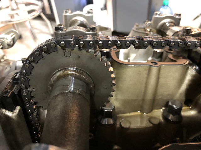

Kind of a side issue about the timing marks- but timely for me as I'm doing the same thing on this very early edition bike.
The timing marks on the camshaft sprockets as shown in all the manuals and bikes I've seen are a punch marks.
Not so on this set.
[/attachment] [attachment=10631]thumbnail_IMG_1192.jpg[/attachment
