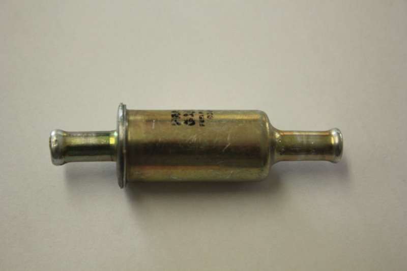

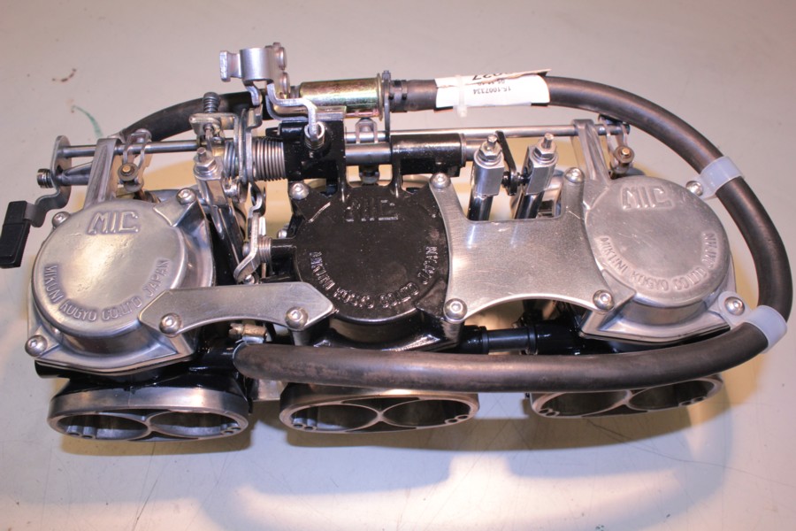

After rebuilding I configured two sets of cabs like this, for a 1300 owner
WIX # 33027 used these for years. Don't let it's size fool you.

The following user(s) said Thank You: dcarver220b, zed_thirteen, Ted

That's a clean install Scotch...
