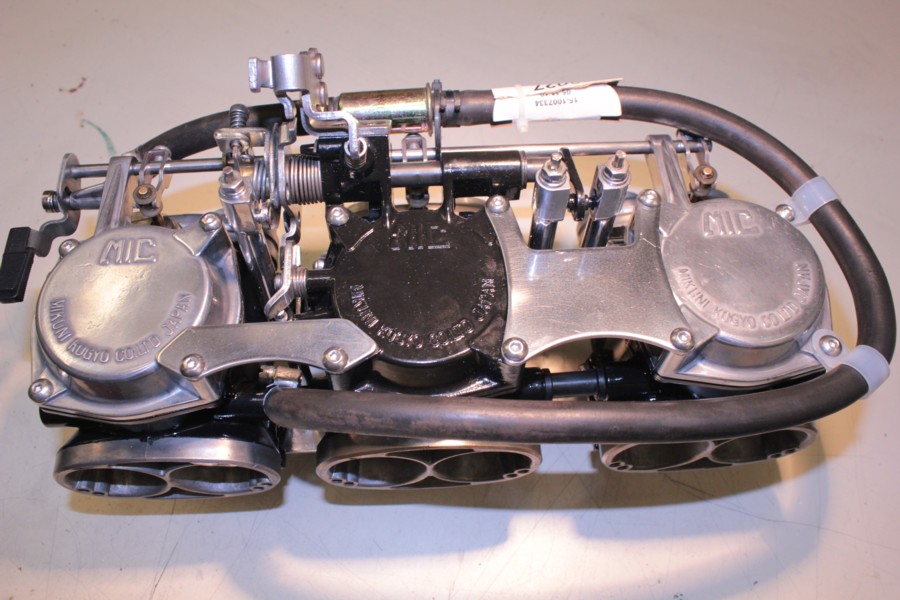

It looks like my fuel solenoid went kablooi (that's American for 'broken') on my '81 A3.  I now have the 3/8 fuel line routed directly to the carbs, but, there's no room for a standard fuel filter available locally.  I haven't seen any on-line that I think will work.  Does anyone half a recommendation?  I can route the line under the carbs similar to the original configuration which will give me room, but obviously don't want to hinder flow.

After rebuilding I configured two sets of cabs like this, for a 1300 owner
 WIX # 33027  used these for years.  Don't let it's size fool you.

That's a clean install Scotch...
