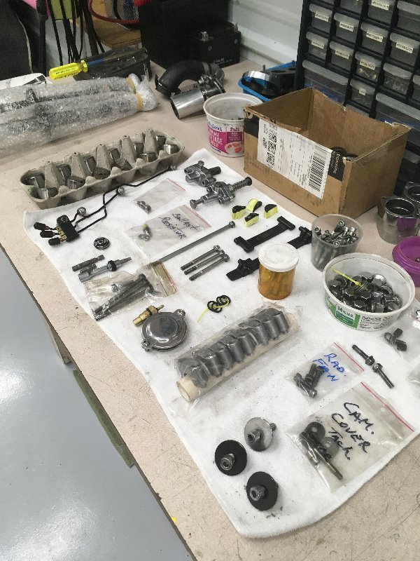

Excellent work with that cam sprocket holder.It's job is done so it's a kitchen drawer cuz it removes lids too

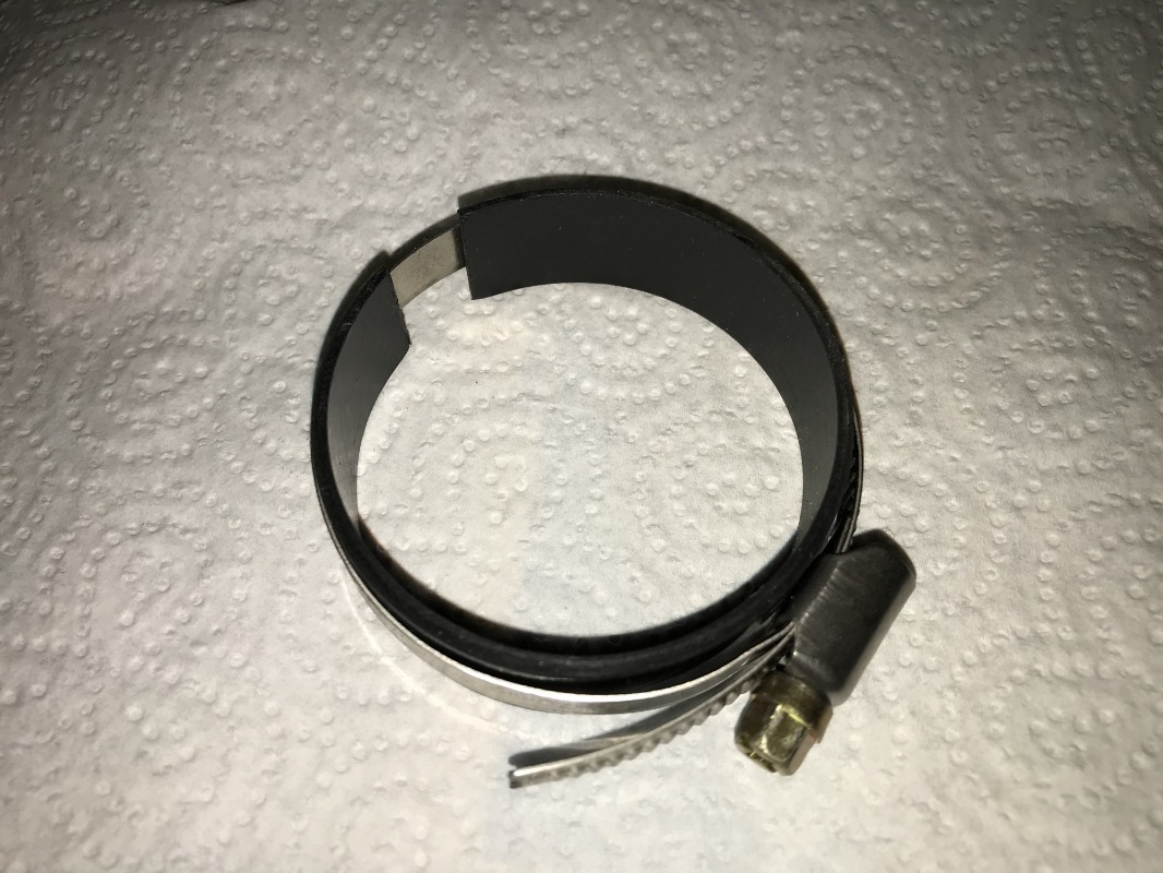

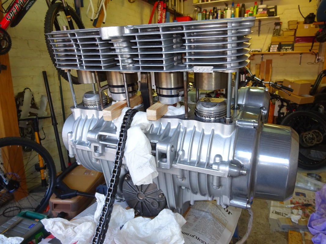

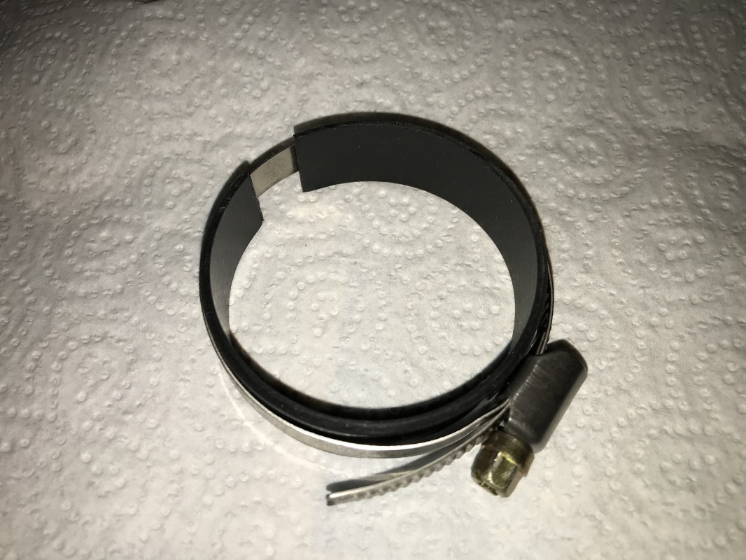

Excellent lateral thinking on your ring compressors. The commercially available clamps are expensive and often too tall for our use. During the Covid lockdown in the UK, I completely renovated my Suzuki GS550 which I bought in 1980 but which sadly gathered dust and rust in the back of my garage whilst I devoted all available time to my Z1300. I stripped and rebuilt the engine (not taken apart in over 40 years!) and assembled this ring compressor to fit the pistons into the cylinder block. It's pretty simple - section of plastic drainpipe tensioned with hose clamp. This worked very well and I only needed two of them. Think your clamps might be easier to fit/remove but probably need more fabrication?

" section of plastic drainpipe tensioned with hose clamp."
What ever works. A common solution a I believe.
