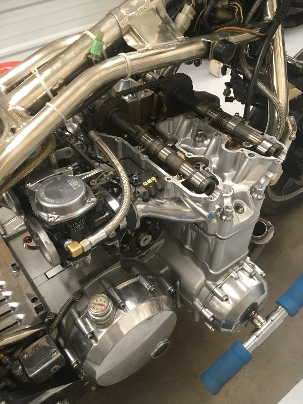

I spent last Sunday afternoon putting things back together. Piston rings were "clocked" at the bench. I ended up using a large sewing needle to move the oil-ring pieces. I pre-shimmed on the bench.. This worked out well. I need to buy 6 new shims but the shims that are in these specific valves at least allow the cams to be installed. NOTE: You can not rotate the cams without ALL shims (any size shims) in place. The cam-lobe(s) will become "trapped" in the empty lifters !

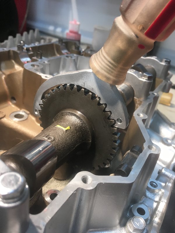

The cams, being independent without the cam-chain, wanted to self rotate so I made this. Well worth the two hours.

You’ve made good progress, scotch.
Excellent work with that cam sprocket holder.

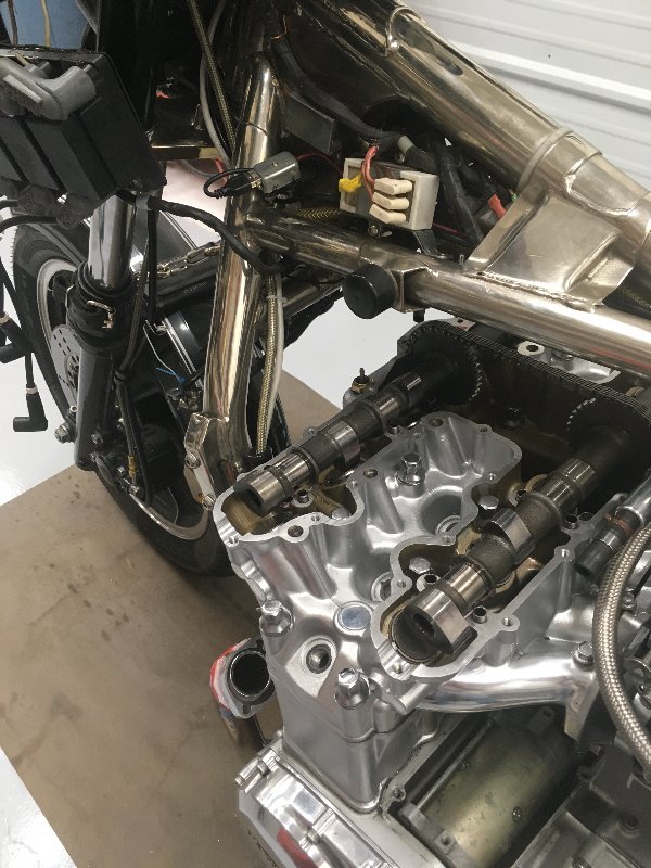

I feel uncomfortable seeing the cams in with the chain on and no cam caps on

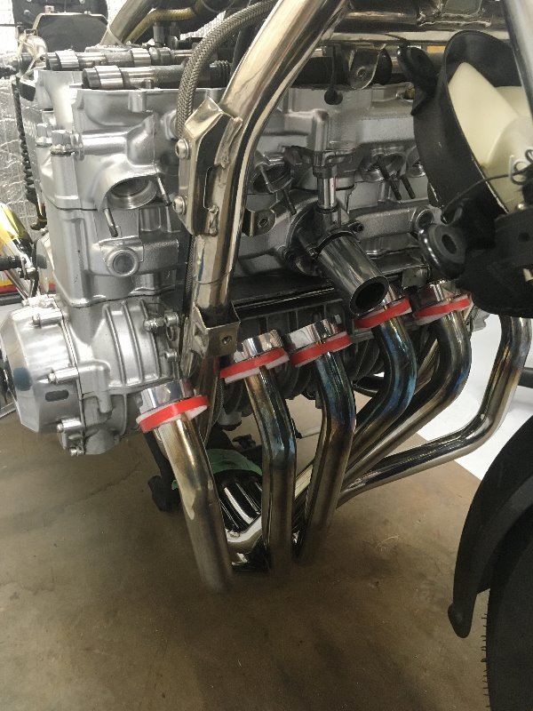

Hmmmm, Intake manifold test port above #5-6 intake tract. Interesting mod.

Regarding cam chain, no caps.. my bet is no tension on chain from tensioner yet?
