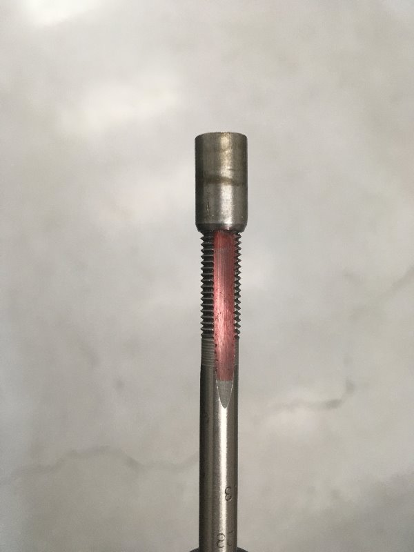

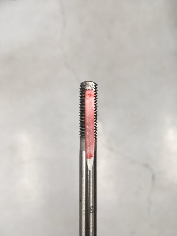

Just add some clarity to the removing of dowel-pins. The intent is to fit an appropriate size tap that "Just" starts to thread in. Used a Red marker to show the how little it takes.
