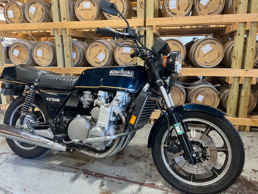

First off thanks for reinstating my post, after all the input I feel like it’s only manners to give an update.
The weather finally cleared and I managed to get out for a short test run. I only did about 50 miles but it was enough to bed the seal in. Coolant was dripping out of the telltale hole as I was warming the motor up before I set off so I tucked a plastic milk bottle filled with a 50/50 mix of neat anti freeze and distilled water inside my jacket just in case. The temperature gauge stayed in the normal range for the whole ride and stopping after about ten miles the coolant had stopped dripping from the telltale. The bike has run fine since so it appears that sometimes the seal does need to bed in. So once again thanks for the advice and I’m so glad the site is back up and running again

WooHoo Paul! Love a success story :)
