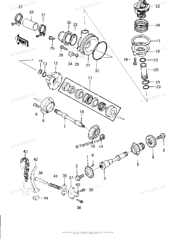

Looking at the diagram copied from Partzilla, you need to remove the mechanical seal retainer item #8 from the cylinder head and you should be able to drive out the mechanical seal from the retainer from the back side. Be CAREFUL how you support the retainer and don't crack it in half. And you're right, the PO glued it in place so I would consider heating it up a bit first to breakdown the glue before attempting to drive out the seal.
The following user(s) said Thank You: dcarver220b

Progress today! After RTFM, discovered the backing plate assembly is removeable.Bought a couple of bolts w' big heads then pulled the assembly out. EzPz when you know how!
