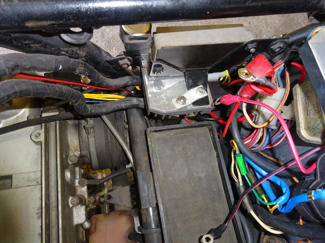

Not sure if this helps but I took some pictures that show the earth cable when I fitted a Shindengen regulator. The airbox and carbs have been removed which shows the earth cable attached to the back of the block, passing under the battery tray and feed up next to the battery on the left of the bike behind the battery.

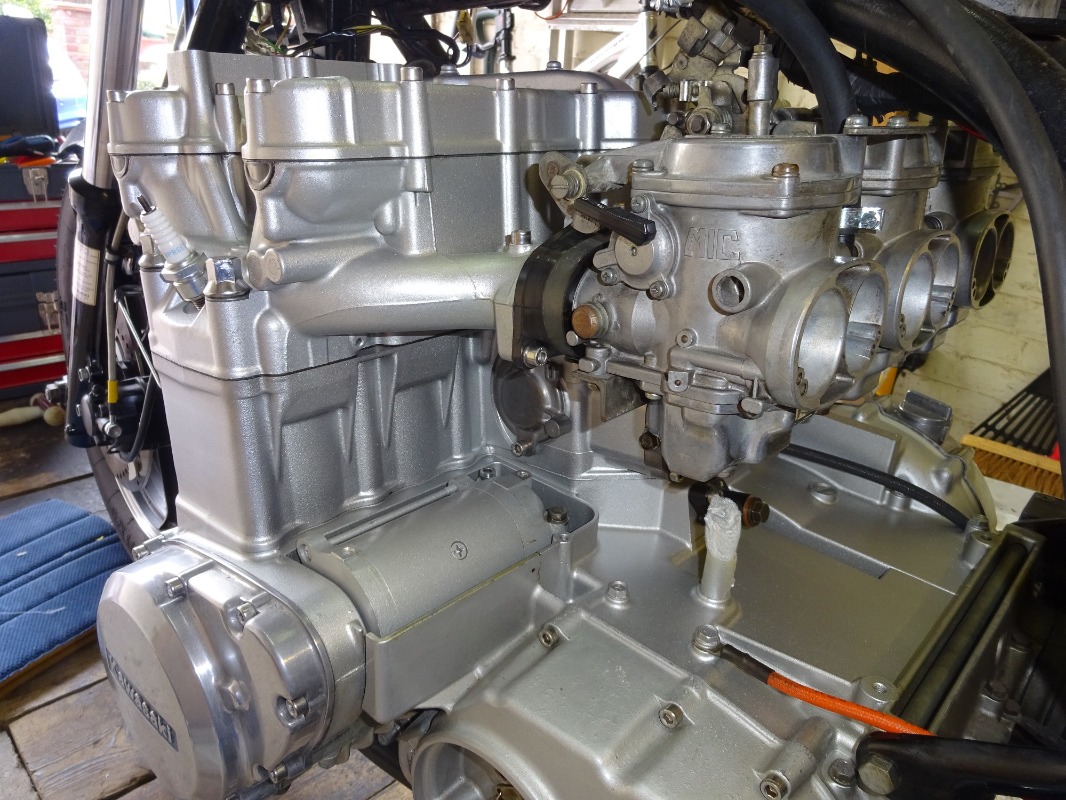

However, I also have had issues with the earth cable so have fitted a second cable - the orange wire in the pic below. This is connected to the block via one of the accessible crankcase joining bolts on the left side and then feeds under the battery tray as before and up to the battery terminal.
