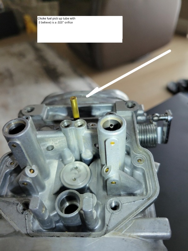

Now I'm really lost. If you can't keep it running on choke something's really off. So probably time to pull the carbs. Specifically look for debris in the float bowl. The choke fuel pick up tube is the brass tube that fits in a bore in the float bowl. On the end of the pick up tube should be a brass orifice that's about .020" in diameter. if for some reason debris got into the float bowl, that orifice could be plugged and starving fuel to the choke circuit. (and why it struggles to run on choke)

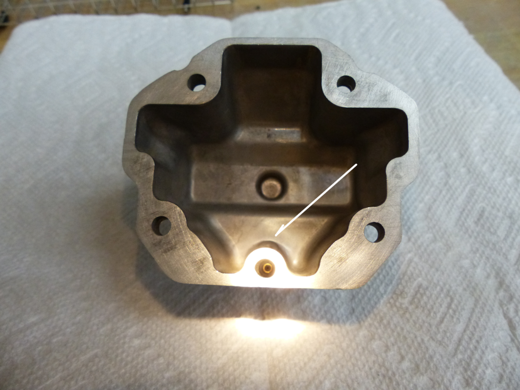

Also, in the bottom of the float bowl there's a port that feeds gas into the bore in the float bowl that the choke fuel pick up tube goes in.
That's the fuel supply port to the bore that feeds the choke fuel pick up tube. On the 3 carbs I had that came with my bike, 2 of the 3 ports were blocked with crud and I had to poke them out with a drill bit. Note- there's a fuel supply control orifice in the bottom of the float bowl with as I remember it a .025" - .030" diameter. You wouldn't see it unless you spotted it with a flashlight. (like I did.)
Then off the top of my head, as I remember it, that choke fuel pick up tube is also an emulsion tube and has small air ports in the sides of the tube, which need to be free and clear. Clearing the choke fuel pick up tube orifice requires compressed air to reverse flow from the choke plunger to blow clear that orifice. If you find ANY debris in the float bowl, Likely the idle jet (s) are plugged as well since they are smaller than the choke orifice. Bottom line- If you find debris in the float bowl, you need to understand how it got in there in the first place. Do you know the specs of the fuel filter you are using??Is it possible that something between the fuel filter and the float bowl broke free due to the fresh gas dissolving the varnish that held the debris to that part of the fuel system??These carbs as previously stated are 6 individual carbs with conjoined float bowls, but each of the 6 carbs are feeding gas to a cylinder of 220 cc's which is not much larger than a chainsaw cylinder so all of the jets, emulsion tubes orifices and air jets are really tiny compared to say a 4 barrel carb feeding a 5 liter engine.. Working on them you need to keep that in mind and realize that cleanliness is next to Godliness. Be patient. You'll get through this. and as always, we are here to help.
KB
