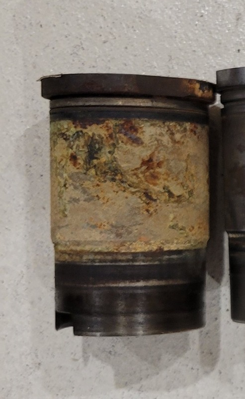

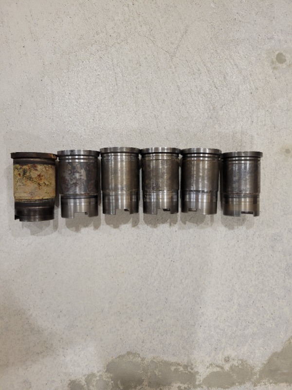

After seeing the cylinder liners I pulled out of my cylinder block and inspecting, those liners are bare cast steel with no corrosive coating on them at all. I don't know how many wet sleeve engines use bare cast steel liners but I do know that if you were to opt for say the best of the best wet sleeves "Darton Sleeves" they come with a Phosphating coating for corrosion protection. Now that I know what material the liners are made of and seeing the fugglyness of the liners, I will not use a coolant other than waterless. and I understand that all antifreezes have corrosion protection but if there's something better out there and the price difference is $20, why wouldn't you switch??

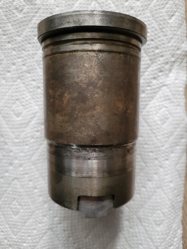

At this point, 5 of the 6 cylinders have been roughly cleaned up (i.e. not completely) and they do clean up. My concern is that after 40K KMs they build up was about .030" thick and I see that as a thermal barrier. Not to my liking.
This one was cleaned up with a smooth flat file for about 10 minutes and it's far from being ready for installation as far as I'm concerned.
As removed from the cylinder block .Like I said "Fuggly"
