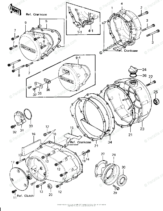

2024-01-20 Oil SeepageWhat's behind this cover? Anything going to spring out?
Partzilla doesn't show a gasket for it...
[img
Can these tensioners be removed for new gasket or is there danger of slipping a tooth?
[img
Hopefully not a base gasket leak.
[img

Item #33  -  45mm o ring behind the timing shaft cover (which is the access for removing the timing shaft sprocket). Just crankcase pressure .if you have to remove the tensioners do so very carefully and don't move the crankshaft until the tensioners are back in and confirm the camshaft timing before turning over the engine.

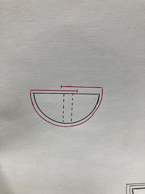

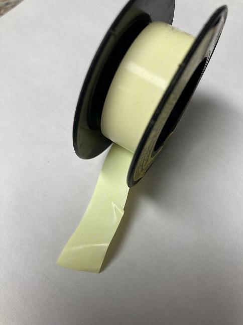

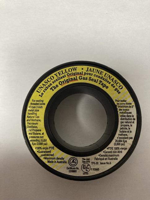

This solved my weeping issues MANY years ago. This "Pipe Fitters" tape is much thicker than standard "Teflon" tape.

Well, that's a great idea! Thanks. I hate to pull the valve cover again.. but I hate leaks even more.
I'm not sure if Ray replaced o-rings when reassembling but I doubt it, given the current issues.
