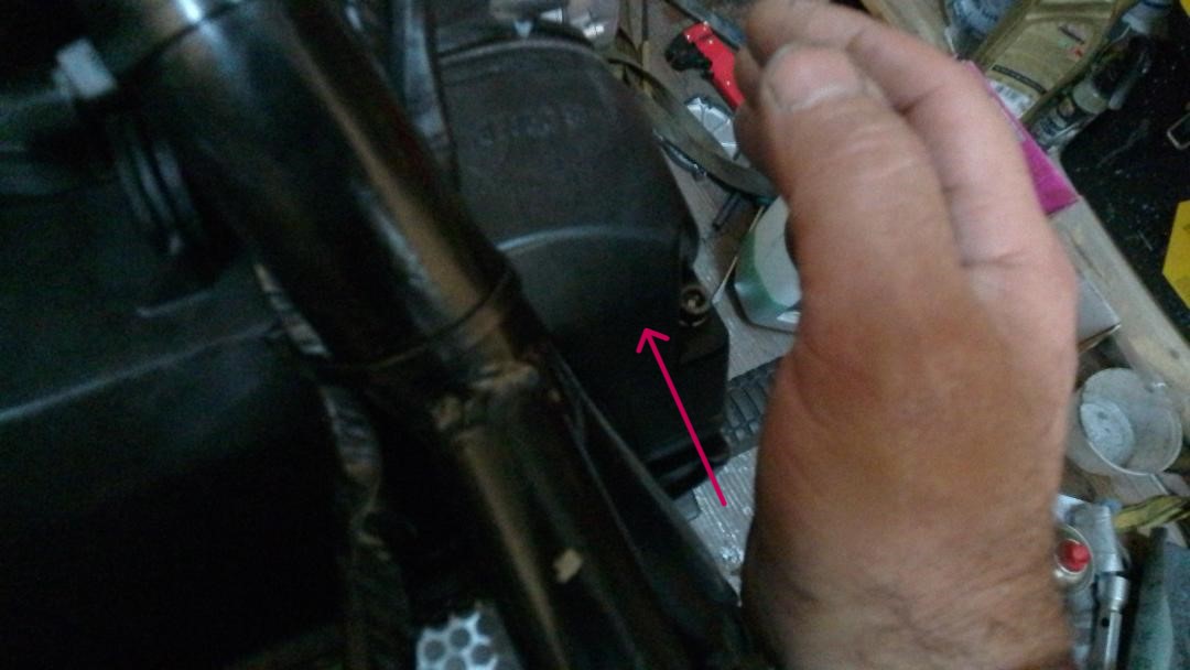

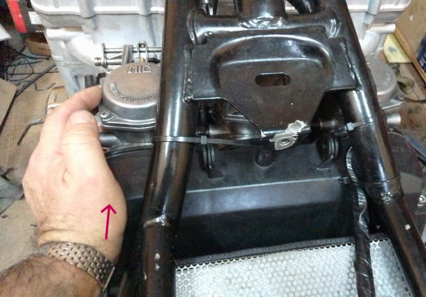

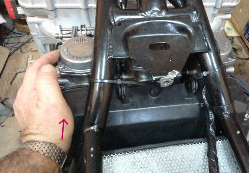

Re: Top Airbox Install Using Shims
2 years 2 months ago
I agree more with Scotch's answer.
Previously, the carburetor flanges are loosened and the rear part is raised a little.
I greased the boots with oil and inserted the carburetor boot on the left side using pressure with the palm of my hand.
Without stopping to apply pressure with my left hand, I give a strong blow with the palm of my right hand and the boots enter by themselves.
Call me primitive if you want but using the technique of freeing a stuck drawer has worked for me every time.
