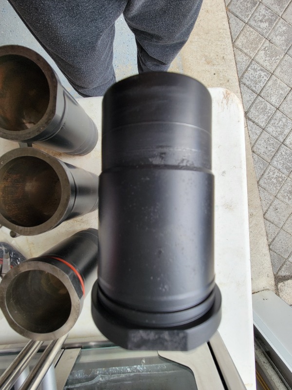

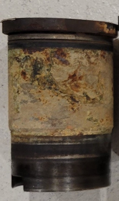

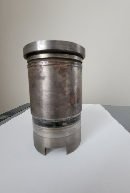

Last summer I pulled the sleeves out of my cylinder block and this is what I found. Pretty ugly. I restored the sleeves and reinserted back in to the block, but I don't want to see this corrosion again.
This was 1 of 6 all the same.
This what they looked like after cleaning up with a smooth file on a lathe.
And finally, after applying Ceracote
