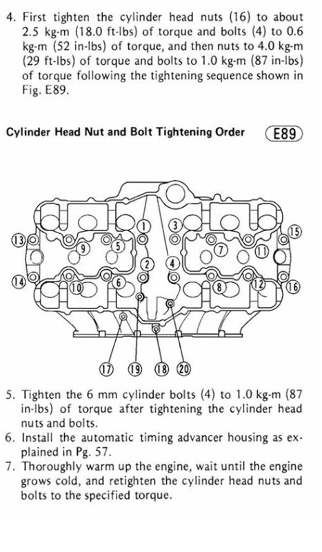

Hi Guy's can anyone give me a accurate setting for the cylinder head nuts please in Lbs-ft

Found on page 79 of the Factory Service Manual

Many thanks for the info
