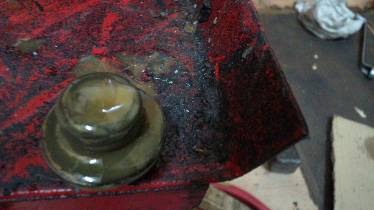

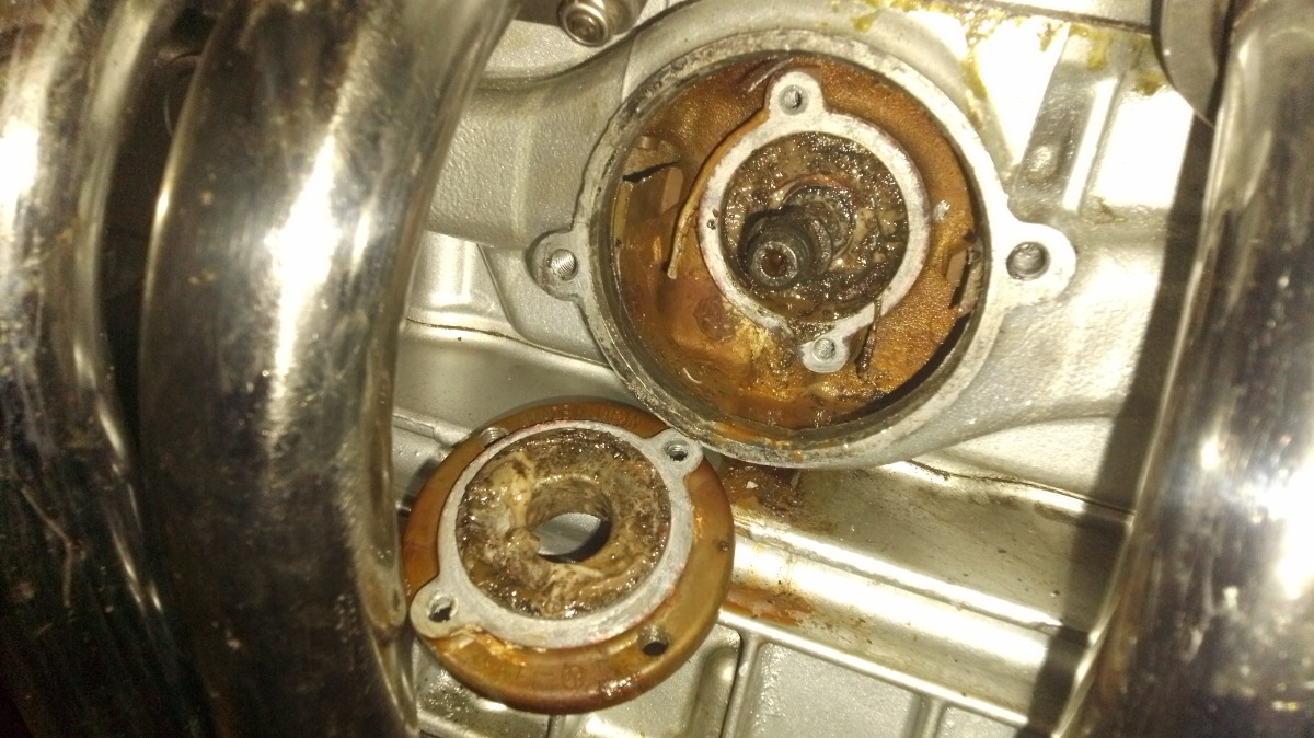

Draining the oil pan and finding the plug like this is not funny at all, nor is it good for the engine.
Although you can try filling the seal with pastry cream, as the previous owner of my motorcycle did.

Thanks for the info, i have every intention of doing the seal and at the moment it is just a small oil leak which i am hoping is going down the weep hole rather than the coolant getting into the engine but will probably take the safer option if the result is going to be the same as your photos
