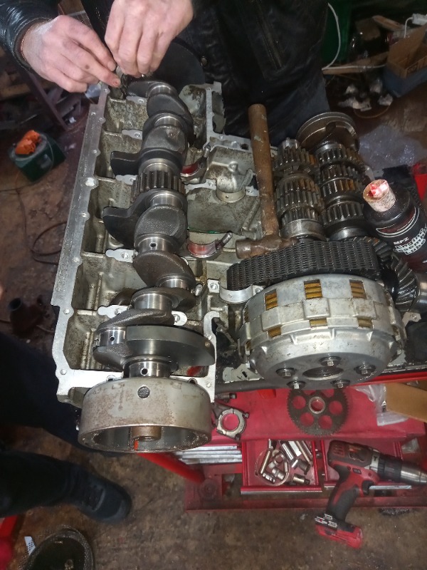

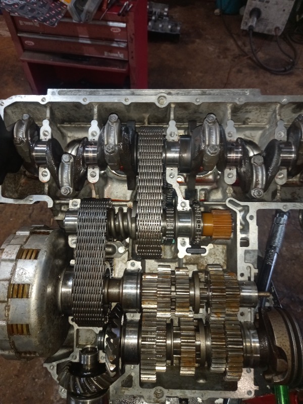

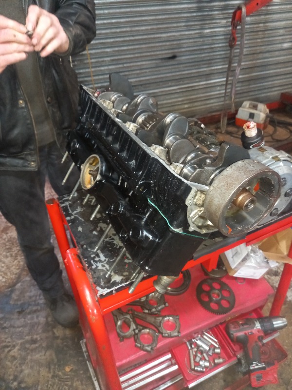

Hi folks.
just a heads up if you're going deep inside.
I found it much easier putting the pistons in the bores, securing the barrels to the top case and then lowering the crank over all the rods together. I had 2 friends help but it was easier than getting 18 rings into the barrels the conventional way.
