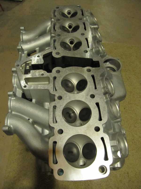

I just had my 1300 head done this summer. Had 65K miles on it and needed a valve job. The seals were toast and the valves showed signs of cupping and had to be replaced. You can find some NOS factory valves if you look around but for a complete set you can buy Vesrah parts. They are good quality. Don't know where you are, but you can't get exhaust valves in the US, I had to buy a set from Z-Power in the UK, it was not cheap. In hind sight I would have been better off getting a set of stainless valves made. Guides and seals are 7mm and can be found easily. I did not need to replace any of the guides or valve springs. If you need springs you can put heavy duty springs in, the 13's share springs and buckets with the 4 cylinder kz1000's. Good luck!
Vesrah part numbers are: GG-4013-IN and GG-4013-EX for the valves.
I had this one resurfaced, ported and flow matched on a computerized flow bench.

The machine work and porting cost me $600 plus I had to supply all of the parts. I had it flow bench tested out of curiosity really, I'm putting high lift cams in this engine and need to make sure the head will be able to handle the increased flow.
A simple valve job and resurface should be the range of $200 to $300 I would think. I looked at buying used parts as well, but with all of the work I had put into the head I figured I should put new stuff in. That said going the stainless valve route is actually cheaper if you are faced with needing valves...
