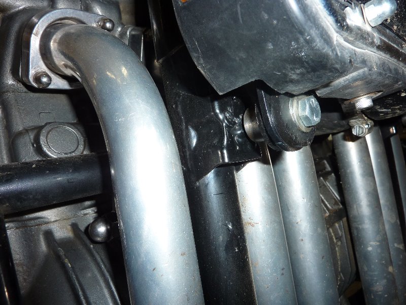

The Jet- Hot can be somewhat of a mixed blessing . If it's going to be applied to a single wall pipe like the DG, I can see it doing something.
I had the stock header pipes done 7 or 8 years ago, mainly because it was a lot cheaper than re-chroming .-less than $300 back then. But with double walled header pipes , the coating obviously goes on the outside , then on one surface of the two inside pipes- no doubt the inner most pipe carrying the gases. All surfaces have to be sand blasted before coating -which is somewhat like powder coating- then it's into the oven. The finished product is a somewhat dull aluminum look.
The collector boxes do have some surface rust on them- probably more an application issue than a fault of the coating.
It still doesn't look as nice as chrome and with the double wall header pipes, wouldn't they do nearly the same thing as the coating on a single wall. If you do it yourself , how do clean the inside of the pipe - unless its' brand new as in Kawboys case.
