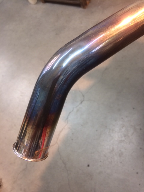

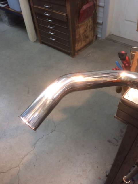

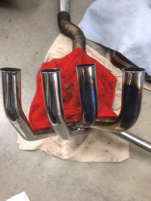

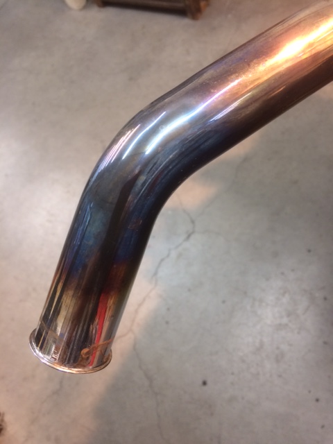

I tried hand polishing the headers but to no avail. However; some WHITE polishing compound on a buffing wheel did the trick. How long it will last has yet to be seen as I expect they'll "Blue" again but I did get the minor dullness out of them, lower down, created by years of being sand-blasted from the front wheel.

A mate of mine swears by a product called "Blue Job" (yeah catchy name) - specifically for blue headers:
blue-job.co.uk/
I've seen the before and after on his old Moto Guzzi's and it does seem to work.

I suppose the headers are single walled ?
Just asking, because the original Z13 headers are double-walled which prevents discoloration.

Yes - DG's are single wall.
