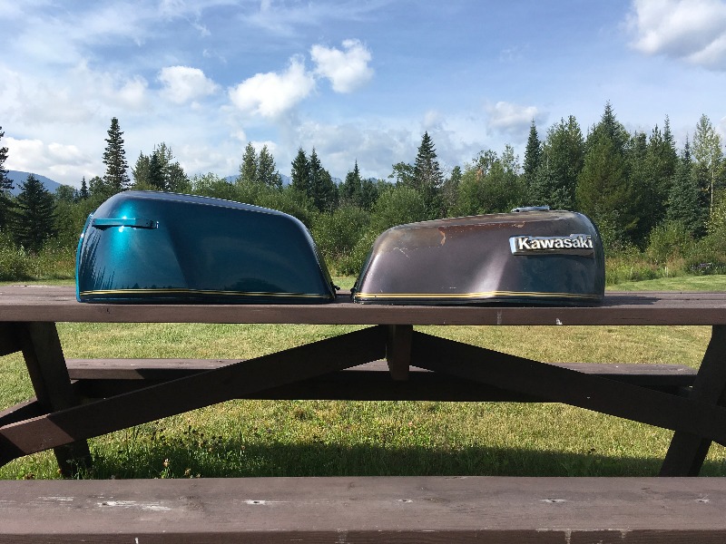

There are the total of 3 tanks:
KZ1300: 20.5 & 21.4 litres (peanut-tank/ the round one and the more cubic one as shown on the photo)
Z1300 & (K)Z1300 B1: 27 litres
sorry, no idea about the dimensions though I believe that the square-ones can be easily changed.

Measuring both while still mounted on the bike i get - 1980 kz 17 3/4" wide,24" long, and 9 1/2" tall at the gas cap. 1980 kz b-2 touring 18" wide,24" long, 10 3/4" tall. Like i said thats still mounted on the bikes so i may be off by a small amount. Hope this helps.
1980 Kz 1300 b2 touring
1980 kz 1300 A2
1980 kz 1300 A2
