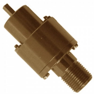

The front wheel drives are the same. The "guts" for a MPH and a KPH look identical but they are not.  The gearing in the head itself is different, which allows for the various face plate increments.  I discovered this when I had to cannibalize 2 instrument clusters to create a new cluster on a recent '79 "Barn-Find" restoration.
You would have to install a mechanical converter on the front wheel-drive
