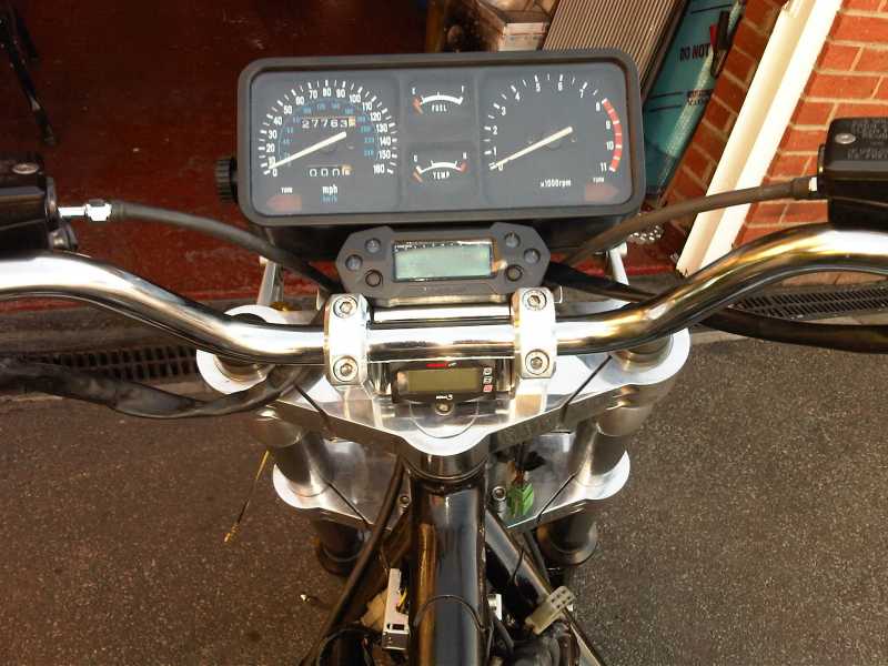

rebuilt my speed&tach yesterday to improve needle response and try to glue the needles back on. The needles were so badly sun damaged that they literally crumbled apart as soon as I tried to touch them! Instead of jigsaw puzzling it all back together I wound up using superglue and glued some sewing needles in their place until I can find a replacement lol (Ghetto I know but doesn't look too bad!).
I found a source for needles in the past but quickly forgot it when I figured I could just glue the old ones back on (silly me!). Anyone else have the same problem and found a reasonably priced replacement? I know our German friends have some replacements but they generally ask for more money than I'm willing to part with

I just went to a breakers yard & looked for a kawasaki with accident damaged clocks (normally a few) & bought the damaged unit for the needles alone.
Mine are white rather than red but still look good & do the job.
I think the bike was a ZZR1100 ?

Yeh mate, same problem down under, imagine how brittle the needles were on mine after 30 odd years in the aussie sun, they crumbled to dust when touched, I bit the bullet and got new needles from the German site, he got them made up when I asked if he had any, took a few months, that's the z1300.de site, sorry to say they are 27 euros each, and have a special way of replacing them, but they are new, orange and black, and work well, he sends instructions on how to refit the new ones correctly, cheers
P.S. I did try some aftermarket replacement type, trouble is the hole for the pin was too big, another was too short a needle, they have to be just right and balanced to suit the application and to read right

Mine disintegrated also probably due to age. I bought the ones from the German site and yes they are expensive but I can assure you they are excellent quality. They fitted with no drama whatsoever and they are well weighted.
