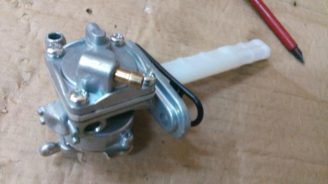

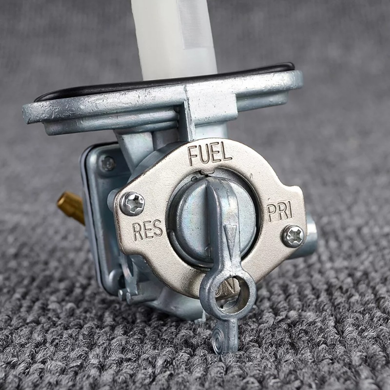

Suzuki GS 1000
petcock.
I have used a Suzuki vacuum valve and it works for me.
I emptied a grease nipple and placed it on the intake manifold.

Does it mount right up like the original or do I have to figure something out to get it to work?
Thanks for your help, I've been struggling for months trying to find a solution.
- kawaBCN
- Posts: 384
- Thanks: 147
Re: Looking for 1979 kz1300 a1 tank petcock
1 year 5 months ago - 1 year 5 months ago

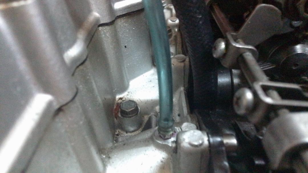

I eliminated the fuel solenoid valve and the housing was the same as the original valve, (44mm between screw holes).
The vacuum tube connected to the intake manifold and the fuel outlet tube to the carburetors.
When you turn off the engine, the petcock closes automatically.
To start the engine after being stopped for a few days, place the key in the PRI position.
Once the engine is running, return the key to the ON position.

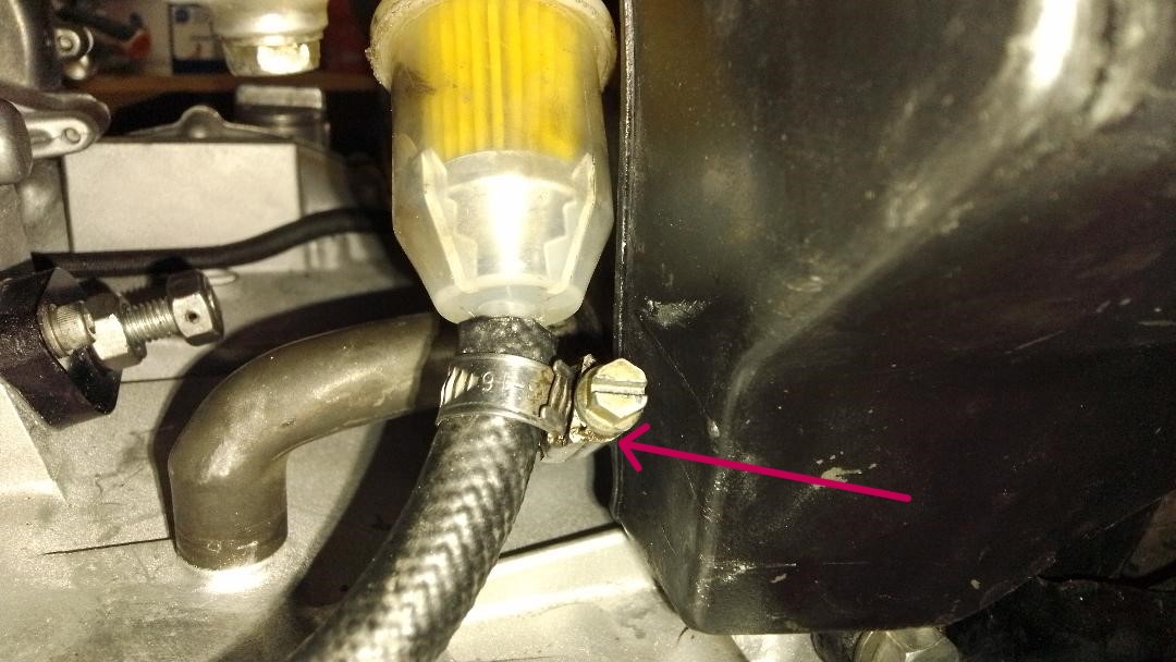

I have placed a clamp to secure the tube and prevent leaks.
Also a floating filter between the tank and the carburetors, my tank had quite a lot of dirt.
RUN LIKE THE WIND¡¡¡
Last edit: 1 year 5 months ago by kawaBCN.
