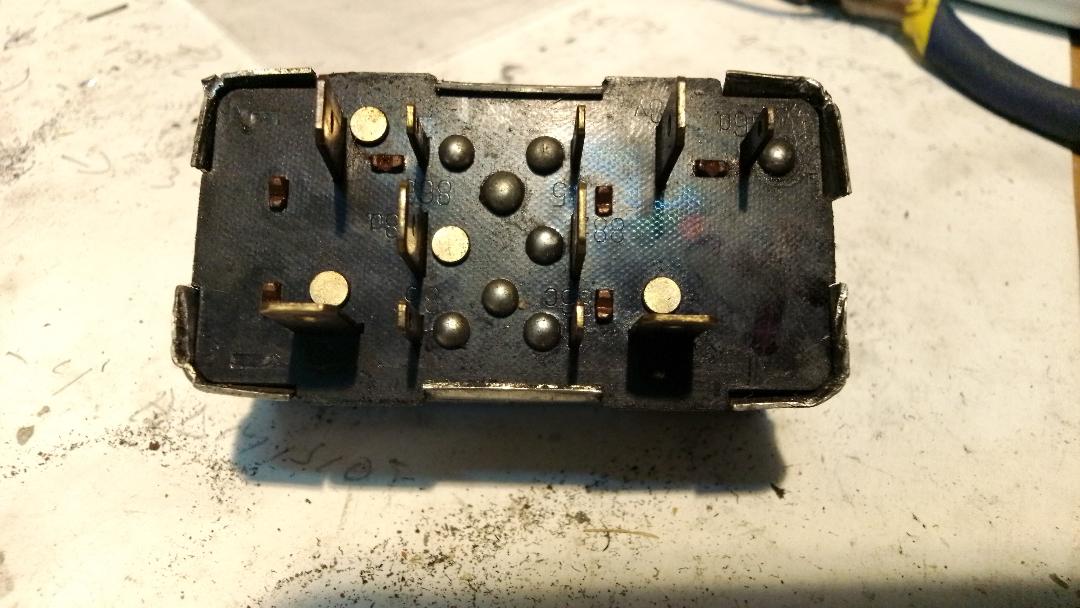

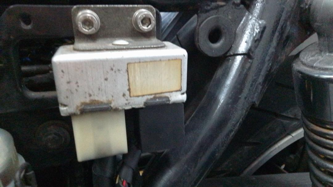

The original relay.

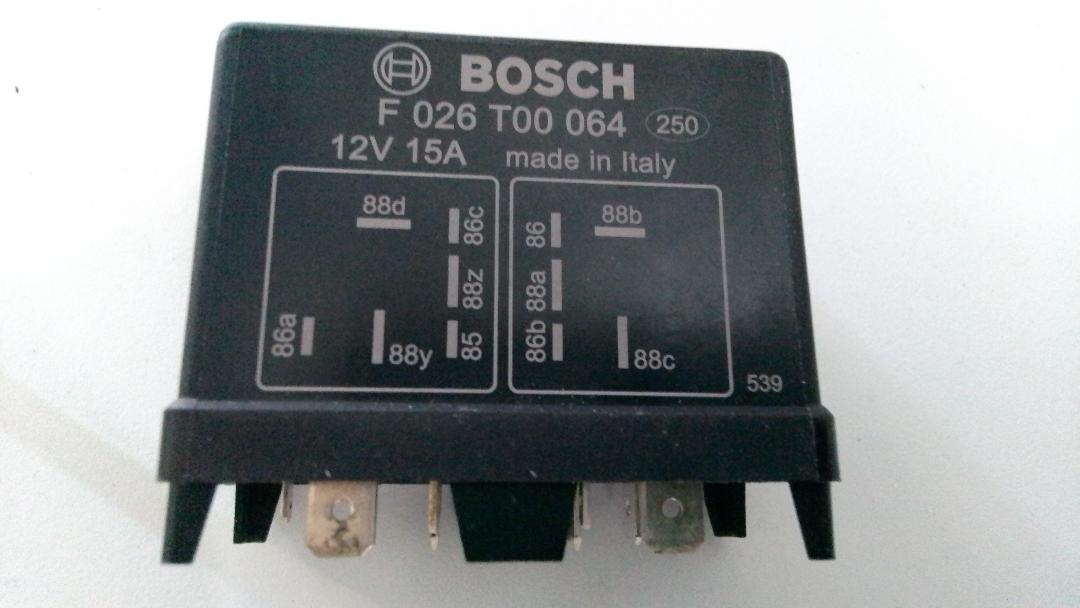

The replace part.

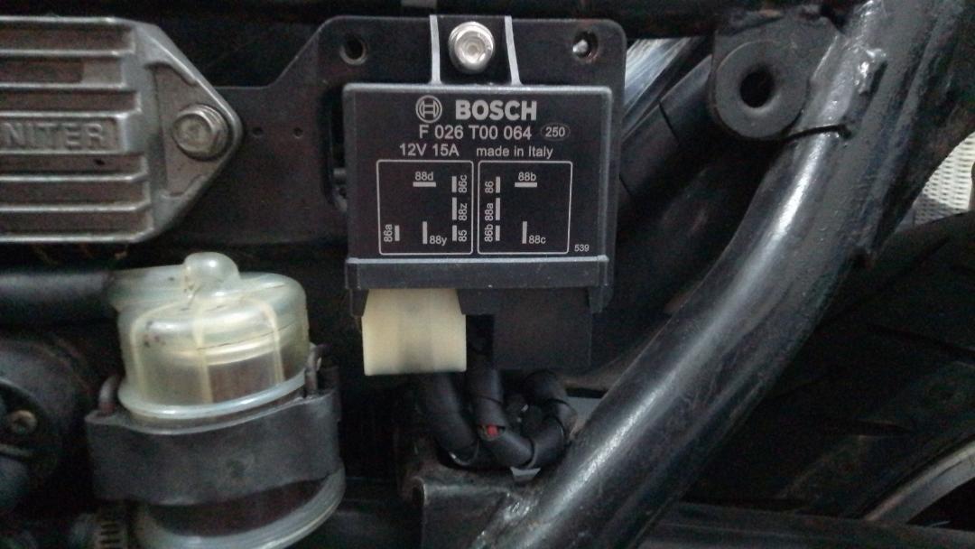

Mounted in the bike.
