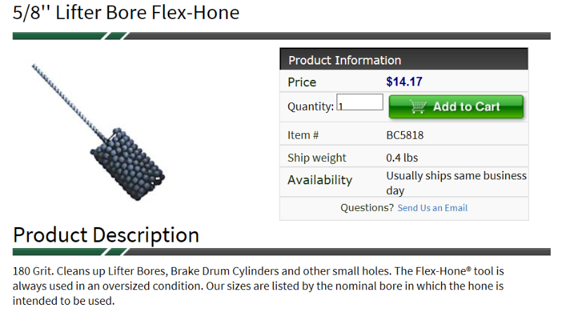

I also ordered a 320 grid flex hone to take a shot at them, but I already think it will not make it good enough. The rest of my master cylinders rebuilding story will go later on my bike's resto page.

Excellent info shows it pays to investigate ! I found this and likely a finer grit is available - didn't look any further. Re-sleeving would be the way to go if the pitting is too deep.

Yes. There is only 10% chance honing will do. I just had to take this chance and try it out.
I will be getting mine from Zoro Canada
The 320 grid is $23. I got 240 and 320. I can always keep it for later use.
