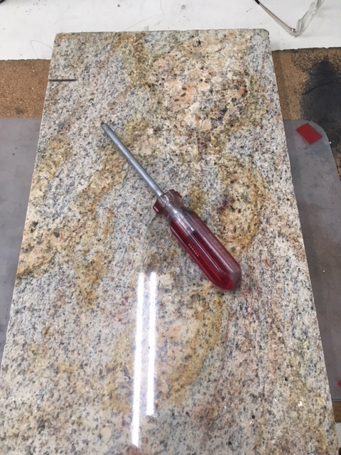

Go to a Counter-Top/Cabinet manufacturer. They'll have a bin of cuttings from Granite tops. The surface is ground and polished. They'll probably give you the piece.
I have used mine for cleaning and dressing cam-cover, side-cases, carb. tops and bowls. I just taped down some W/D abrasive, keep it wet with some water and go at it !

That slab on Amazon looks delicious! That's exactly what I've been looking for, and I am sure you guess why - checking the crankshaft to begin with.
Great idea scotch, I will pay them a visit. But probably it's not precise enough for use with a dial gauge. Definitely handy to have around especially if rescued from a dumpster.
I guess you won't know until you get a piece and check it !
