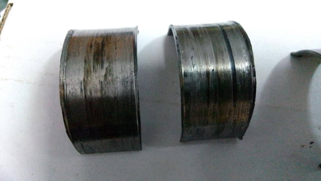

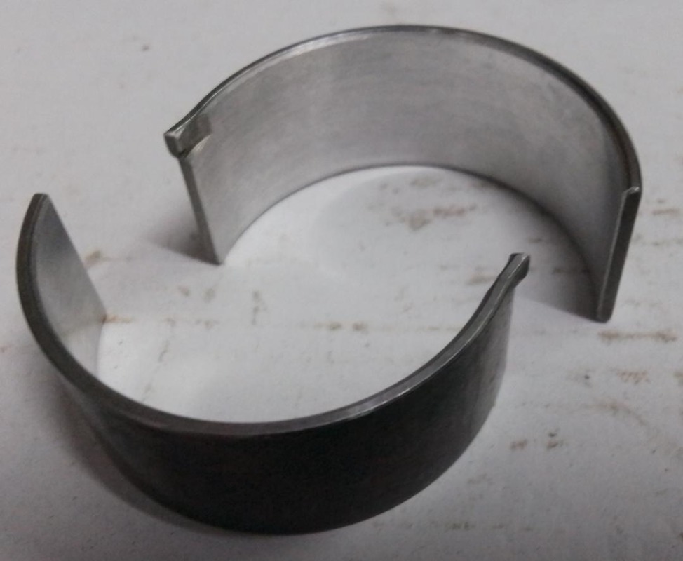

I had to replace the bearings on connecting rod number 5 since it had been repaired by Mackgiver using an empty can to make what I found when disassembling the engine.
Last December I bought a new set at MCG PARTS, I remember they only had one color, brown I think.
As far as the crank bolts are concerned, I didn't change them, I don't see the need to do so.

As you can seeI think McGiver had a hand in the repair of this engine, thanks for the quick replies.I will take your advice and check the bolt for markings and contact MCG, hopefully they will have an answer. I did manage to get a second hand crank with the con rods already on, which is in very good nick, there doesn't appear to be any looseness or lateral movement on any of the rods, any suggestions on how to confirm bearings are ok? I thought I would change them as a matter of course seeing the engine cylinders have been re-bored out to 63mm. Once again guys thanks for the feedback.
