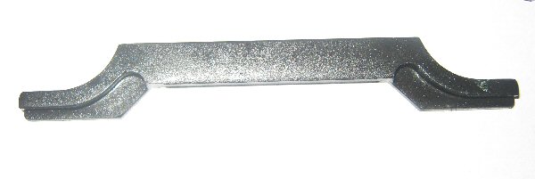

AND make sure you put a cover or a rag in the cam chain tunnel, hate to see you drop a shim down into the motor, also those cheap shim tools are not real good, the lever is great but if possible try and find the "proper tool" like the one I have in the photo below

12 years 2 months agoExcellent point on the tools.
If one looks in the factory shop manual, Kawasaki provides a cam chain cavity cover pattern to fill that cavernous hole.
It's an intricate pattern that covers all of the nooks and crannies.
This brings up another tool to have, A long and strong retractable magnet.......
T.
