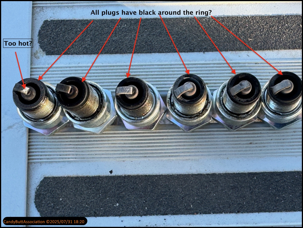

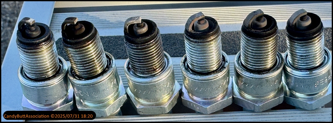

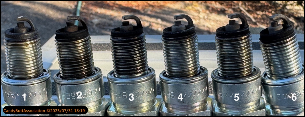

What about the bike - are you now happy with the fuel mixture and spark plug readings?
Oil consumption is now reasonable. Last tank hit it with a heavy dose of Yamaha Ring Free.
Plugs 1&2 show a bit black still. .. but that carb is messed up... some hack, not me, stripped the pilot jet threads then jammed a needle and jet from who knows what.. different threads, length, and I could never get good flow from that circuit using the 'Scotch Tool'. I have 4 spare racks now... and will get back to it when time allows. For now, good enough to ride!
