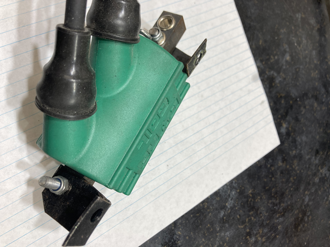

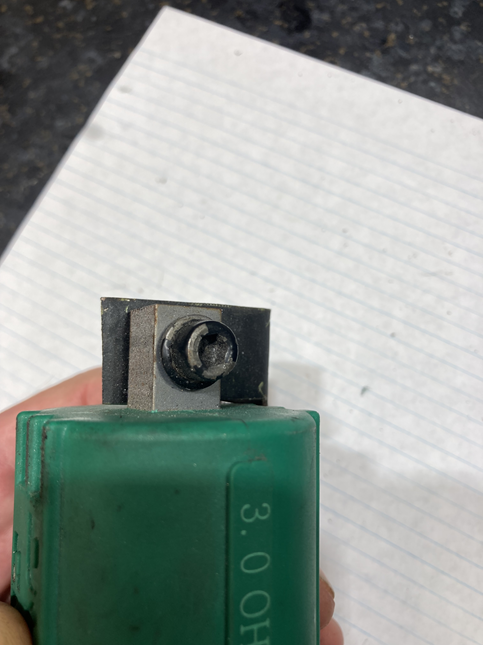

The Nology coils were mounted poorly with the bottom left coil boots and leads touching the frame with some cross-firing resulting.

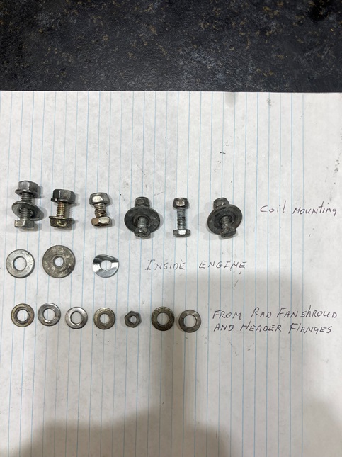

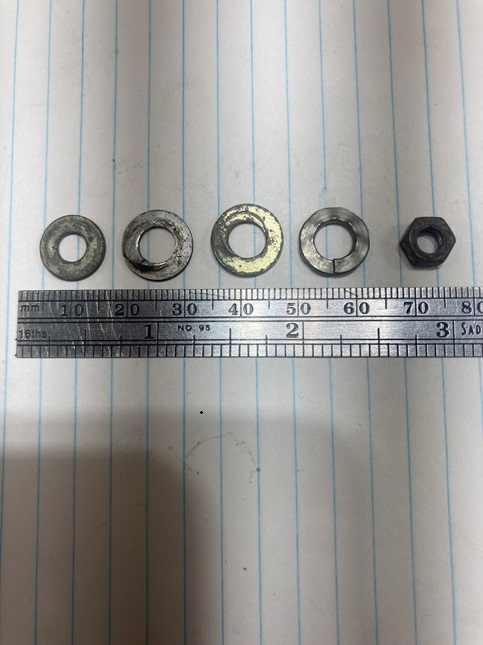

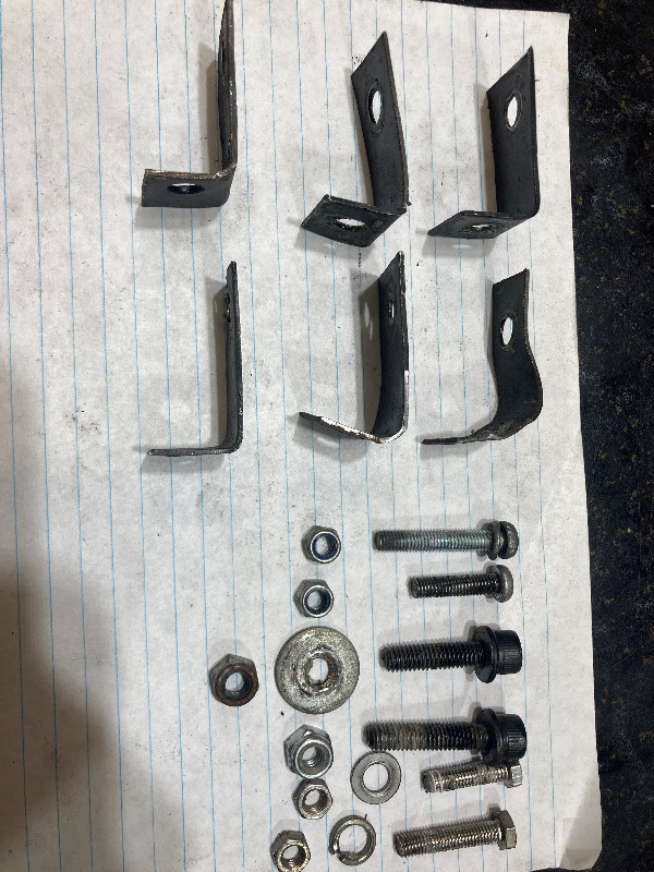

I now know how all of the washers ended up inside the cam chain tunnel (plus several in the fan shroud and several more caught between the exhaust flanges and the Cyl head). And of course: Plus the one that went through the cam chain sprocket and secondary-shaft gear, causing the chain to derail. Whether the coils were being mounted (dry fitted) when the head gasket was replaced or simply with the cam cover off to facilitate the fitting; the angle brackets used, created an awkward somewhat frustrating task for me to remove. It didn't help that different fasteners were employed along with self locking nuts.
I too dropped several nuts and washers but at least had the common sense to cover the open engine with a large towel along with a previously made foam cam chain tunnel "plug". It is still beyond the scope of my imagination to understand how anyone could be so careless, unaware, negligent and/or indifferent, but....."To each their own" !

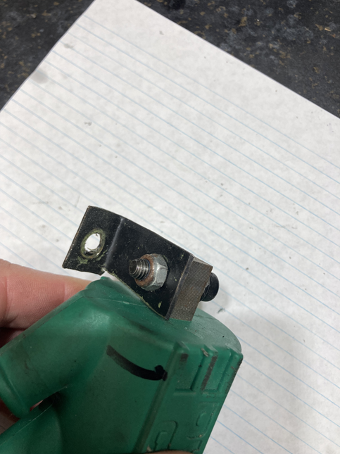

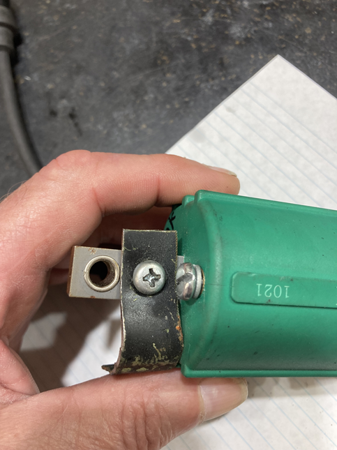

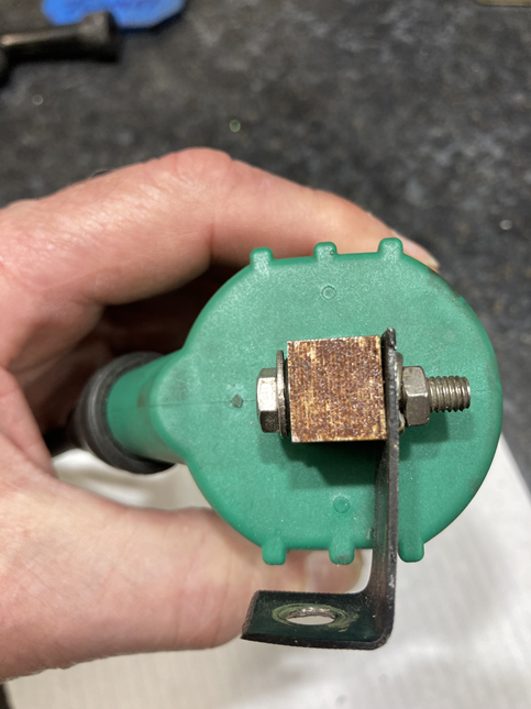

It's too bad Nology positioned the hollow rivets (used to secure the core laminations and to provide a means of mounting), in the horizontal orientation; from the perspective of mounting on a 1300. Had they been oriented vertically; mounting would be so much easier !
The brackets have been straitened, trimmed to a more uniform size and the razor sharp corners and edges have been dealt with. A more sensible and user friendly means of mounting, as a result.

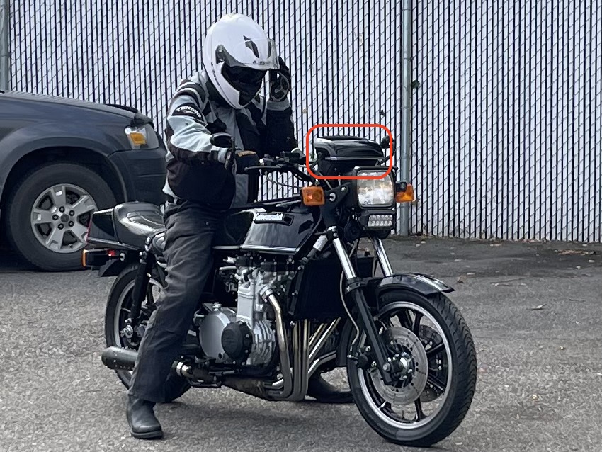

On both bikes; it creates a smooth laminar air flow from the otherwise very turbulent air coming over the headlight and instrument cluster. It really works ! No more feeling like my head/helmet is inside a base drum being struck by a dozen monkeys.

1 month 1 week agoIs it something you made, or is it available commercially?On both bikes; it creates a smooth laminar air flow from the otherwise very turbulent air coming over the headlight and instrument cluster. It really works ! No more feeling like my head/helmet is inside a base drum being struck by a dozen monkeys.

I made them.
