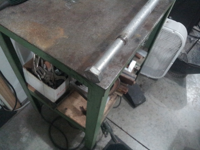

Well, I have a new adventure I'm about to embark on- replacing the fork seals on my KZ1300. :sick: It's been a LONG time since I've done one of the these, and while the manual is pretty straightforward about the process, I am still going to need a tool to prevent the inside of the fork from spinning when I remove and replace the bolt on the bottom.
Back when I did this on my XS1100, you could improvise a tool with a nut welded to a rod. I'm guessing a similar thing can be done with the KZ1300- I just need to know what size nut to use.
Anyone have any suggestions?

#11981
Hi Lucien,
I welded two 5/8" bolts into a piece of EMT that's 42" long. The heads of the bolts are 7/8" hexes. It worked great.
Bill

KZQ wrote: Hi Lucien,
Bill
i was going to suggest that once you have used the impact gun to remove the bolt you can then take the forks to pieces for cleaning
and while your at it measure the hole for a bolt but as you can see Bill has beaten me to it.
spot on Bill..
