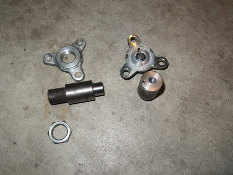

I had to drill and tap larger than 8mm to get them out, I think I went to 10 or 12mm fine thread. I used a large impact socket and a heavy grade washer under the bolt to make a puller. I tightened the bolt and the hit the head with a hammer to break the pin loose then used the bolt to finish extracting it. I had ZERO luck with a slide hammer.
Interesting to note, the very early 1300's had a threaded swing arm pin. I had to replace my swing arm and the used one I bought came with this style of pin and holder. I think they are FAR superior to the press in type with the set screws. I would try and find a set like this when you put it back together, they are much easier to adjust the swing arm preload and position. AND they will come back apart much easier.

9 years 11 months agoTyler wrote: I had to drill and tap larger than 8mm to get them out, I think I went to 10 or 12mm fine thread. I used a large impact socket and a heavy grade washer under the bolt to make a puller. I tightened the bolt and the hit the head with a hammer to break the pin loose then used the bolt to finish extracting it. I had ZERO luck with a slide hammer.
I've gotta say it surprised me when I discovered the 13 had this set-up for the swingarm pivot - every other shaft drive bike I've ever worked on has had screw in pins like the ones you have pictured above.
Thanks for the tip on cutting a bigger thread - I'll have a go with the slide hammer and heat on the M8 but it's good to know I can up the size if that plan turns to poo.
