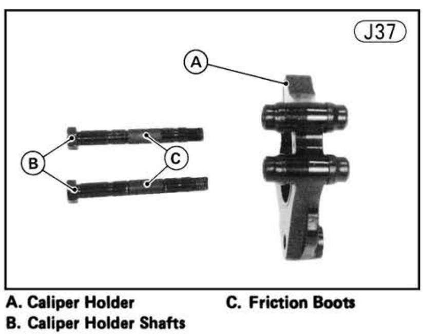

First is the caliper holder shafts and specifically the friction boots. One of the friction boots has disintegrated completely, what can I use to replace these friction boots?

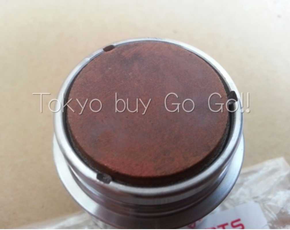

The top of the brake piston usually has some sort of compound in it and I have one piston where it is missing, can I still use that piston?

As far as the friction boots go, try and find some hose that is the same ID and outer size - possibly some non-braided fuel hose?
Not sure about the caliper piston, although many have a "puck" that sits inside the hollow of the piston to stop noise. All the ones I've seen on other bikes can be removed without any problems.

Thanks Hillsy, found this caliper set on fleebay that includes the friction boots and I need the dust covers anyway: -
Yep the puck you refer to is glued and permanent on the Z1300 pads. I shall try very judiciously without the puck as I won't get my new piston until probably the new year

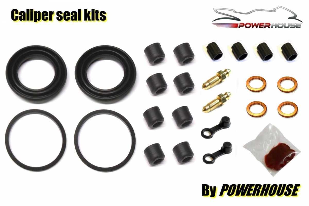

I've bought brake kits from powehouse and I have always found them to be very good.
