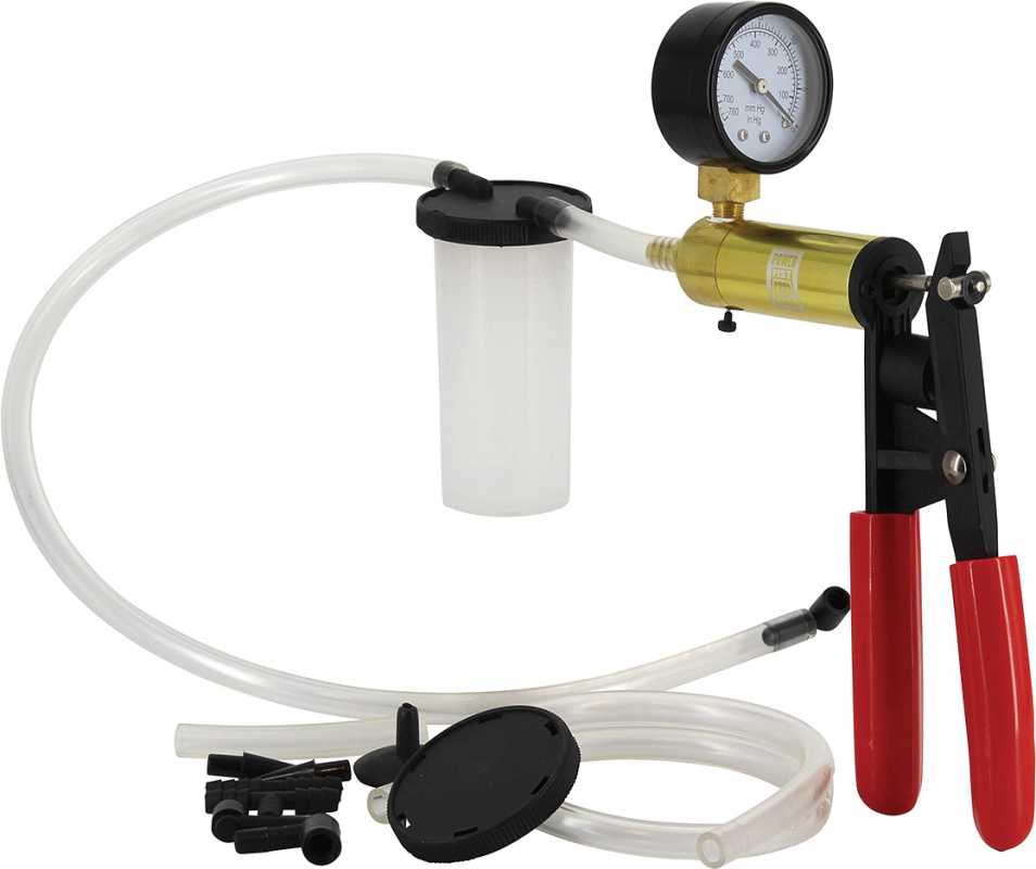

No argument that bleeding the air by yourself can be a pain but I somehow managed. Non-the-less, about three years ago I picked up a vacuum-pump designed for this purpose. Typically about $50.00+ I purchased mine on sale for $29.00 (Princess Auto - Canada). Made the bleeding task a piece-o-cake - so much easier and quicker and as far as I'm concerned paid for itself the first time it was used.
