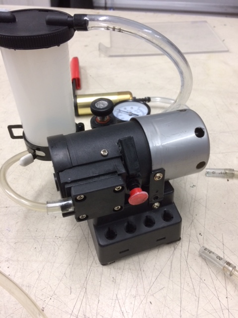

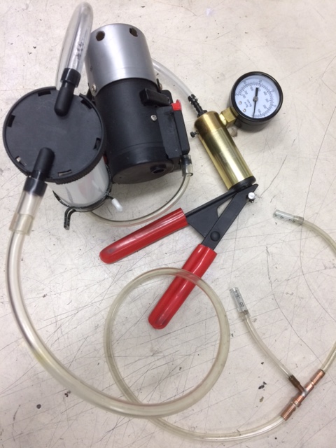

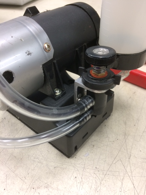

Finally got the pads and put the calipers back on yesterday. While waiting for parts I had a Brain-Fart and came up with this. No other reason then to see If it would work. And it does - almost too well.
Basically it's the vacuum-pump from a Kitchen Vacuum Sealer with some odds and ends. Runs off a 12volt 1000ma power supply. About 2"hg vacuum and it evacuates both calipers simultaneously and almost too quickly.. I had to watch the reservoir level closely. The hand vac-pump was connected merely for the gauge.

Your Brain farts pure genius. We should delay your purchases more often. If this is what your brain farts out, i can't imagine what's "stuck in there".
