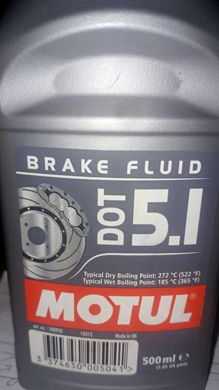

I used this DOT 5.1 fluid as a good replacement on other bikes. 5 is not good. Synthetic and mineral don't mix. Does this one work for our bikes?

I use exclusively DOT 5 in all my old bikes, but you're right, 5 and other types of brake fluid do not (and should not ever be) mix(ed). I go to great lengths to completely drain, disassemble, and clean all components before switching to 5.

Yes, that's it Buco. DOT4 can be mixed with DOT5.1, but not with #5. It would create jelly. My other bike has #4 recommendation and it was discussed on a related forum to safely use #5.1. In my case, ALL system will be spanking clean so either would work. But I am using the 5.1 for other bikes, so I will stick to it. I also changed lines to Teflon stainless steel braided lines on the Vmax. The old rubber lines expand and I am sure this would be the case of our KZt's. Since replacing them with braided lines the brakes became noticeably more responsive. I'd definitely suggest this upgrade to any of the old bikes.
