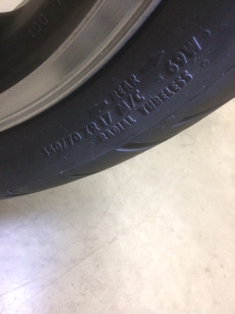

An answer to a P.M. question - This is what I'm rolling on:

Who makes it?
And how did you come up with this size? I know i am repeating myself, but looking at the data on the Tacoma tire size comparison calculator, size 80 seems to match better the original size. I might be missing something looking at this, these tire sizes give me always a headache and can't get myself to really study them.

I don't wish to pee on your fire but a fella fitted a 150 section tyre to his Z1300 here in the UK & found that as the rim is designed originally for a 130 section it distorted the carcass so that the contact area was about the same as the 130. When I had standard wheels I have fitted a one size larger than standard 140 section & found that OK. For me that is the biggest you can go safely on a standard rear rim. Just my opinion ;)

Someone put a 140/80-17 on my bike and when I was cutting the tire off the rim I can say that it was really tight and fit well. I am wondering about larger sizes in general, and I want to research it well, hear real life experiences. Once I purchase a tire it is gong to stay with me for a long time! Looking at the tire size calculator, the sidewall height can change dramatically with different tire sizes. I've read that even on a 140 the tire can experience quite a sidewall flex making it in to a different experience. A wider tire doesn't always mean better ride. It's a vast and complex subject.
