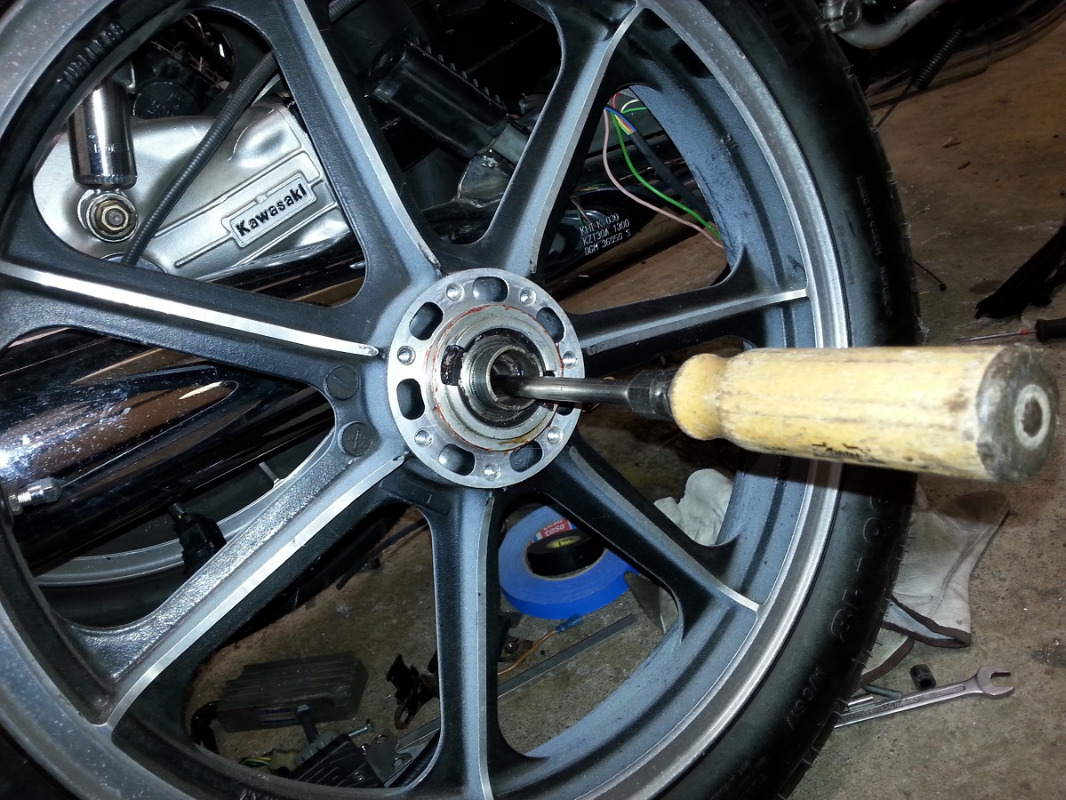

I've always had to knock them out with a punch from the opposite side. They'll have to be replaced after that of course. If there's a spacer between the bearings it's just about impossible to use a puller.

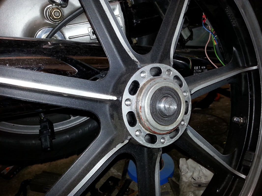

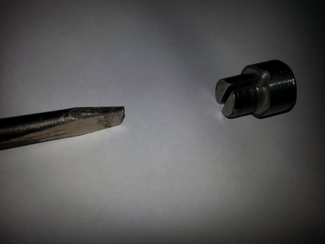

There are pullers for it Bucko. I had Proto but it got worn and had to toss it. It's ridiculous here in Vancouver - I end up wasting hours looking for something and 'not available'! Such a small basic selection of everything here. Such a contrast to the USA. Same Amazon etc. - such a small selection comparing to across the border. Always waiting and waiting for everything..., as it has to be ordered form Ontario or Quebec!

There are similar available in the USA, but I still have to find the one I will like, to eventually buy. At the moment I just paid 20 bucks to have a shop remove one bearing. The punch didn't work unfortunately. (it was a Goldwing not KZ; I don't get why the spacer inside with all the free space isn't 'floating' easy to move out of the way but rather stuck solid between the bearings)

I don't own a blind puller. Had a wheel bearing a couple of weeks ago that I could not get out. Welded a nut over the hole in the bearing, then punched it out from the other side. Problem solved. No $ spent...

Hi Stan i used this to change the bearing in the front wheel. Its home made, cost none, simple and effective.

SO, I was more about a real manufactured tool. Those extractors were about CAN$ 10 each. Than 'punch' is very expensive in comparison, and I am regretting buying it, but what the hell. It can be replaced with a long ground chisel or a screw driver.
