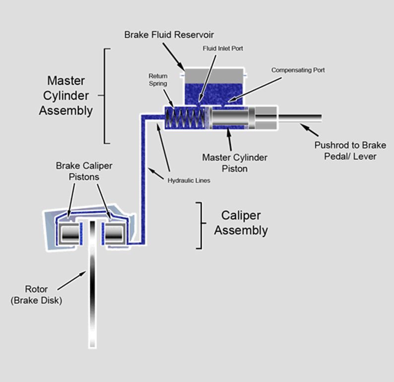

If you have to "pump" the brakes to achieved a "hard" lever then in all probability there's air in the brake lines.
The caliper boots and seals have nothing to do with removing applied brake application pressure. The spring in the M/C returns the this piston to "Home" and in doing so draws back the fluid - which removes the applied pressure to the brake- pads .
There is no "check-valve" anywhere in the system, nor can there be for what should be an obvious reason.

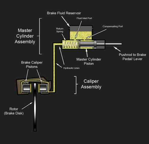

Minor point but your diagram has the equalizing/compensating port (smaller of the two ports) and fluid inlet port positions swapped (at least for modern motorcycles). And slave cylinder piston seals (square ones anyway) absolutely help with retraction of the pistons. You can verify this when bleeding the brakes: apply the brakes, when the bleed valve is opened, the pistons will retract slightly even though the master cylinder piston has not moved from it's fully 'engaged' position

Not my diagram ! Copied from the net. as with the Following:
I guess they're all wrong.
Not going to debate whether the "seals and boots" retract the pistons. For the purpose of clarity - The spring in the M/C returns the M/C piston - thereby pulling the caliper pistons away from the disc. when the lever application pressure is nil. Fluid Dynamics !
